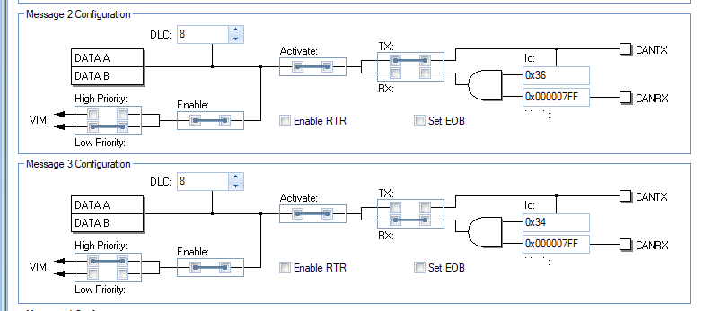

I am a newbie who really wants to learn developing embedded applications. I have a TMS570LS launchpad and i am trying to communicate with launchpad through peakCAN. My application requirement is this; it should be able to receive a message with ID 0x34, light the LEDs according to the first byte of the message i'll receive, read the state of the LEDs and transmit a message back to the network indicating the state of the LEDs.
 My HalCoGEN configuration;
I have configured message box 2 as transmit with the ID of 0x36 and box 3 as receive with 0x34.
My code;

But this doesn't work. Code compiles successfully, LEDs light when i change the initial values from the array itself, LEDs states can be read and transmitted over CAN but receive is not happening. When i debug the canGetData function itself, i see it moves forward but when i uncomment while(!canIsRxMessageArrived) program stucks there, indicating message box is not receiving anything. Where i am doing wrong ? As i said i am a newbie and any help would be highly appreciated. Thank you.
