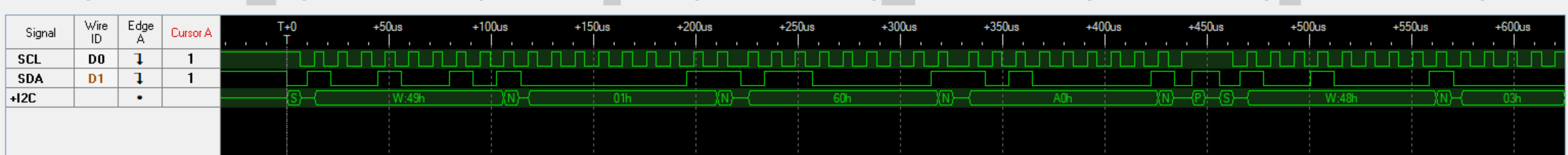

While executing this code using XDS200 connected to TM4C123GH6PM. It was observed that no I2C clock and SDA transactions.

  • OK, I don't have a hardware setup yet, but some things I have run into. When I compiled the files you sent I got an error that TMP102_54VADD_R was not defined. If this is the slave address of the TMP102, then it is the same as the write address. You only supply the 7 bits, the function changes the 8th, read/write bit. You don't define separate addresses for read and write. If the A0 pin is tied high, then this would be 0x49.
    I also see in line 70 of main.c a direct register write to clear the FIFO. There is no I2C FIFO on this device. Your code example probably came from a TM4C129x device that does have the I2C FIFO.
  •  I ran the code (including the write to the non-existent FIFO control) and I see the appropriate SCL and SDA pin toggles. I don't have a TMP102 attached so I have NAK instead of ACK. Here is the logic analyzer trace. You might want to double check all of your hardware connections.
  • Thank you Bob,
    After doing the required changes I am able to see the I2C transaction.
    Now, I am able to read temp sensor (tmp102) registers. I am getting default values of temp registers (temp_high & temp_low) as 80 & 75. Need to implement the correct logic to get the temp value.
