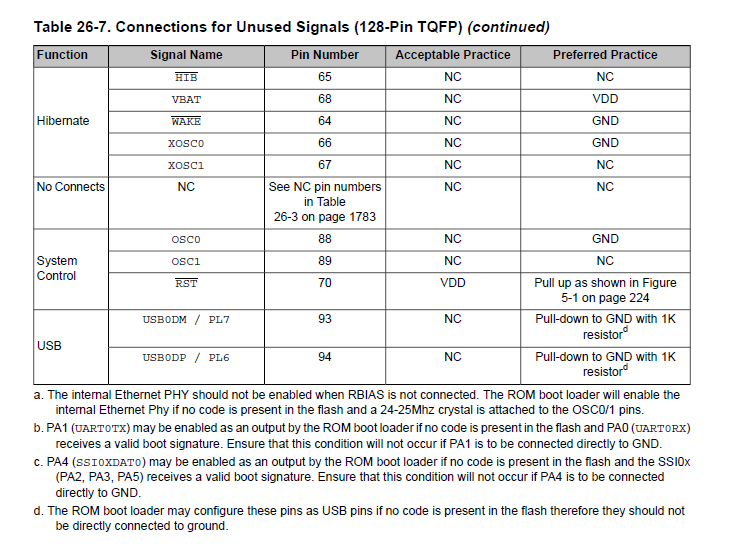

Does errata ELEC#02 relate to unused VBAT preferred practice for unused pins (Table 26-7) VBAT tied to VDD? Should VBAT pin 68 "May be damaged" leads to any other pins being effected such as VDD being pulled down to GND when VBAT has been tied to VDD?
It seems ELEC#02 lists no specific conditions of pin 68 use as previous clarified in datasheet that otherwise seems to contradict Table 26-7.  Does an errata hive a higher priority than tables previously defined unused pins practice in the datasheet? If true why has the datasheet Table 26-7 not been corrected to reflect ELEC#02 if such an errata can directly effect VDD? Perhaps pin 68 preferred practice should not be tied to VDD and instead included a series resistor to stop issues from an unused VBAT pin.
  • The errata document takes precedence as it is more recent. If the ramp rate of Vdd exceeds 0.7V/uS then leaving the unused VBAT pin not connected(NC) would be the preferred practice. Connecting to Vdd with an RC circuit to control the slew rate would be an acceptable practice.

    Since the errata is know to exist and as you seem to infer also effects unused pins table 26-7 should have been updated in later revision datasheets as not to confuse the issue when Hibernate module is not being used. Otherwise errata precedence of ELEC#02 was later determined should be a bit more specific as to the severity or impact to VBAT pin as it relates to previously declared unused pins in table 26-7. The conclusion can be drawn when the hibernate module is not being used per table 26-7 VBAT and ELEC#02 is not a concern.
    Our custom PCB +5v ramp up rate and enable pin produces a soft start into 3v3 LDO, should avoid damaging VBAT. Another concern is for others in the forum who have reported MCU short issue may have tied VBAT to VDD. Seemingly table 26-7 then incorrectly specifies being a preferred practice even when Hibernate module is not being used.
    Note: TM4C design guide seems to concur with Table26-7
    "If a dedicated battery is not going to be used, VBAT can be connected to the same net driving the VDD pins without adding the RC filter."

    Advisory ELEC#02 is because the ESD protection circuit on the VBAT pin is designed to trigger an SCR to help protect the pin from damage in an ESD event. It triggers on the very fast rise time of the voltage during an ESD event. If the supply voltage rises too quickly, it can inadvertently turn on the SCR. A supply voltage, unlike an ESD event is a long time event and therefore has enough energy to cause damage to the device. The advisory is therefore independent of whether the Hibernate module is used or not. Most designs,like yours, the rise time of the supply voltage is slow enough that this issue is not of concern.
