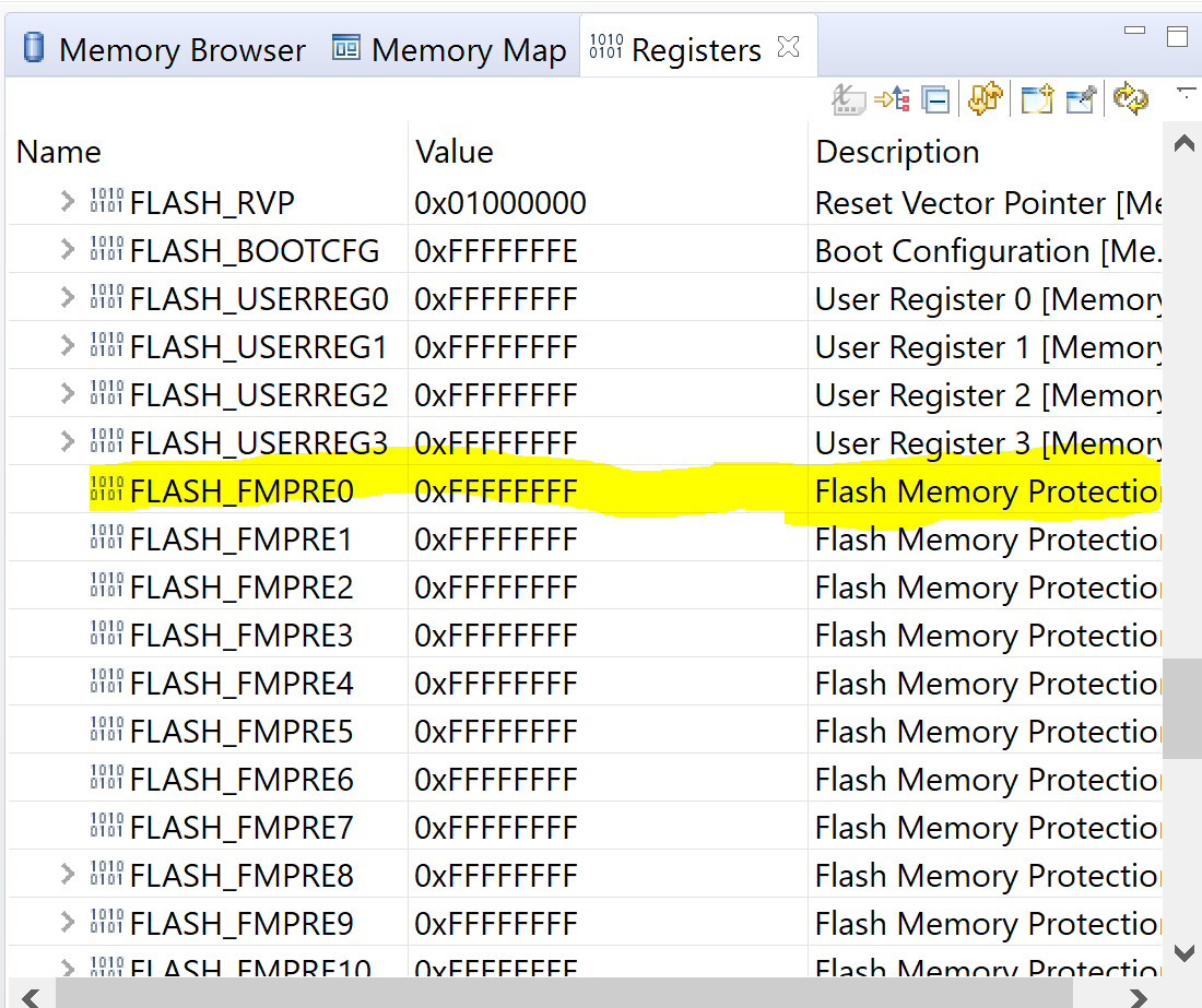

  • Can you still connect with a debugger and see internal memory and registers? If so, can you check that the FMPREO register (flash memory protection register 0) is still 0xFFFFFFFF?
  • Thanks Bob.  No, I'm not able to see the registers once the load failed.  However, while scoping the JTAG signals the device programmed!  So I think it must be a problem with my hardware which I'm checking into.  I'm ready to close this issue as soon as someone can tell me where I can adjust the JTAG clock speed - I don't see a way to manually set it with the Segger programs.
  • It turns out that even though I had the VddC bypass caps close to pin 115, their traces should have been bigger, after running some additional copper it is running much more reliably.  I'll close this issue and open another one with the question about how to set the JTAG speed.
