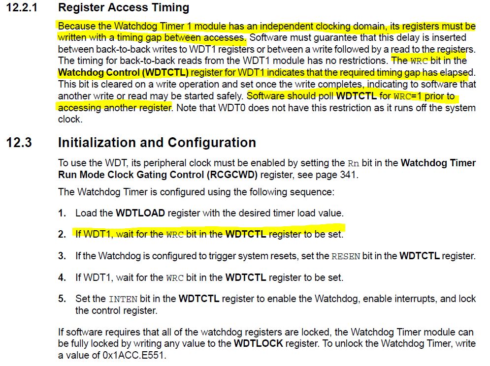

I'm trying to initialize Watchdog Timer 1. I'm using the default clock source
SYSCTL_RCGCWD_R=0x00000002;         // Run Mode Clock Gating Control for WDT1
while(!(SYSCTL_RCGCWD_R & 0x00000002)) ;

      First of all, you are using DRM (direct register manipulation) method to program the MCU. This is prone to mistakes. I will strongly suggest you to use TivaWare library to develop your application. We normally do not support reviewing DRM style of coding. Please see FAQ about this.
      A couple things for you to check.
      1. Is SYSCTL_RCGCWD_R correctly mapped to 0x400FE600?
      2. Do you have the same problem if you were to use WD0
      3. I don't see you poll the WRC bit before accessing the WD1 registers. Please see below.
  • The register address are correct.
    WD Timer 0 works fine.
    I inserted additional  the time after gating the clock to WDT1 module.
    Then even I tried to read the lock register instead of writing. The same problem, Hard Fault.

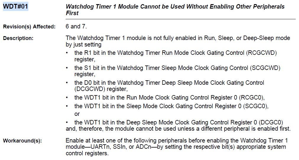

      Looks like you are hitting one of the Watchdog errata. Please refer to the errata document for details. http://www.ti.com/lit/er/spmz849f/spmz849f.pdf You must implement a workaround by enabling another peripheral such as UART1 or SSI1 first before enabling the WD1.
  • I enabled UART0 then I enabled WDT1, that was the solution for hard fault.
