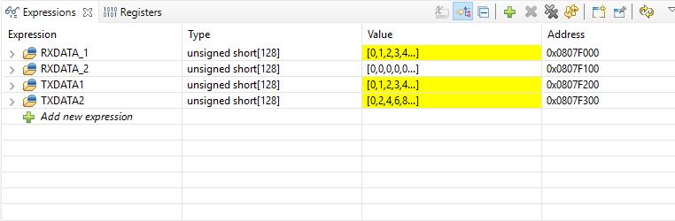

I am trying for the DMA channel chaining mode for the SPI.
In my example, DMA channel 0 has channel 3 in its chain register and this channel 0 is triggered and assigned to request line 1 for spi1 transmission.
similarly for reception of spi, DMA channel 1 has channel 2 in its chain register which is triggered by hardware req.
In Following way i have configured this four packets:

Observations:
As you can see, i am not receiving any data in the second buffer.
As per understanding, after configuring the packets, like here in my case,
for channel 0, when it is triggered by the hardware request it has to automatically chained to the 3.
but seems it is not transferring the control to the other channel neiher for the transmission and reception. that is why i might not getting any data in the second spi buffer.
Can you please assist me in the same.

    I have enabled the DMA for SPI module and that is verified as i am able to receive the data in the DMA_CH1 receive packet.
    Now In the DMA_CH1 configuration i have provided the chaining to the DMA_CH2. But, it is not giving control to the DMA_CH2 packet though DMA_CH1 is triggered once by the Hardware request.
    Do i need to trigger the DMA_CH2 as well? if yes then i have observed the following:
    DMA_CH0:SPI_TX = SIZE 128(frame count)
    IF,
    DMA_CH1:SPI_RX = SIZE 64
    DMA_CH2:SPI_RX = SIZE 64
    so now DMA_CH2 should contain the remaining data. but when we triggered it as well with HW req then it receives the same data as DMA_CH1.
    If DMA_CH0 transmitted data is 0,1,2,3...,127, then
    DMA_CH1 should be 0,1..,63 and DMA_CH2 should be 64,65,...,127.
    How to achieve this reception without loosing any packets in between if data is coming continuously?
    Please Help me out in this as soon as possible.
