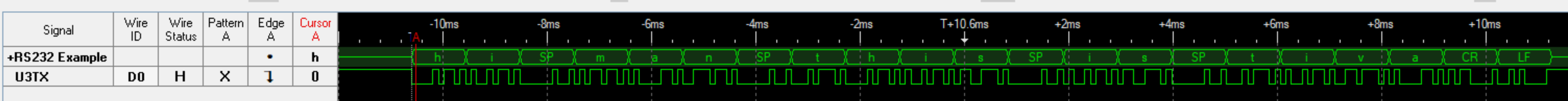

  • Hi,Bob,I  want to know how you got this picture ,could you teach me?
    https://e2e.ti.com/cfs-file/__key/communityserver-discussions-components-files/908/2465.Capture.PNG

    Wang liguo  In laboratory
    I used a USB based logic analyzer / protocol analyzer. The one I have is the Intronix Logicport. It is a bit old. I think it cost about $400 US. There are several brands available. Just do a Web search of "USB Logic Analyzer".
