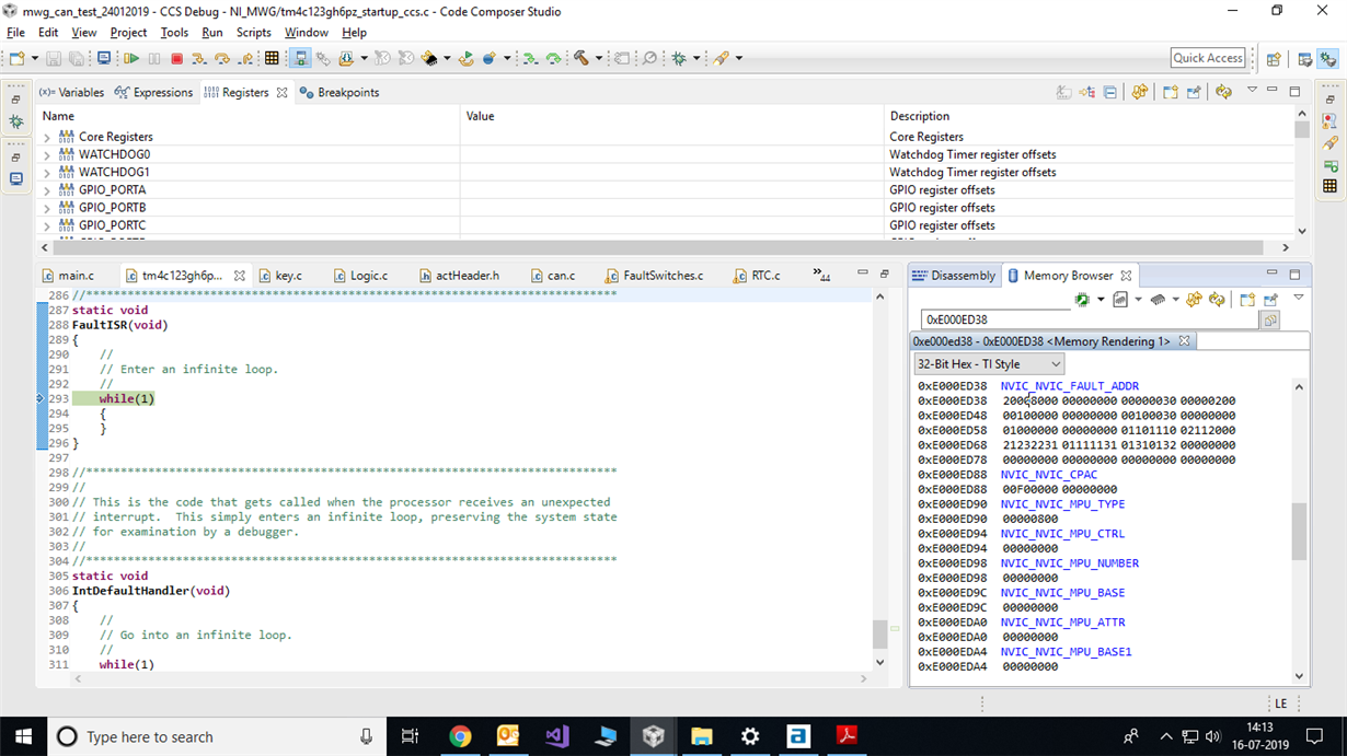

CCS/TM4C123GH6PZ: if UART 5 Rx is disconnected , we are receiving the Fault ISR and and FAULT address is 0x20008000 which is above the SRAM size of 32KB
Part Number: TM4C123GH6PZ
Even RAM data is also corrupting.

    • Have you any 'buffering' components (especially level shifters) between your UART_RX pin and the (dreaded) 'Outside World?'
    • If (either) 'Yes or No' - should not pin 'UART_RX'  be pulled up/down (to some 'Valid Logic Level') - w/that  valid level persisting  (even when - especially when - disconnected from the remote UART Signal) - by the board's design?
    It is (assumed) that the 'Forceful Connection Break' is generating  'disruptive transient impulses' upon UART_RX.   (or even - upon the MCU's supply pins.)
    Proper logic level maintenance at/around UART_RX - along w/a protective series resistor (between UART_RX & the outside world) often will reduce - and (sometimes) correct such an unwanted event...

  • Hi cb1_mobile,
    we have tested after doing the modification in the module by adding the pull up resistor to UART_RX line. which will maintain the high logic on disconnect of remote device.
    STILL we have some questions:
    1. why this is causing the RAM data corruption or SP address in the NVIC_FAULT_ADDR = 0x20008000 .when UART_RX line in float state.
    is there any other care should be taken in software or hardware.
