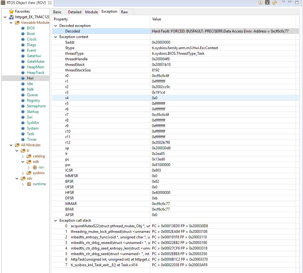

  • Hi Todd,
    I am pursuing this and with help from your posts i'm moving in a right direction but i'm getting an error for BUS FAULT.
    Using slnetifndk.c file I have added the entropy source in the http example but when I'm trying to use mbedtls_ctr_drbg_seed I'm getting an error.
    Hard Fault: FORCED: BUSFAULT: PRECISERR.Data Access Error. Address = 0xcf6c6c77
    I'm trying to find the reason but i'm unable to do so. Do you gys have any idea about this?
    I have also attached the image of my ROV.
    Deepak
  • You have the call stack in the exception view. You need to set some breakpoints and figure out what is causing the exception.

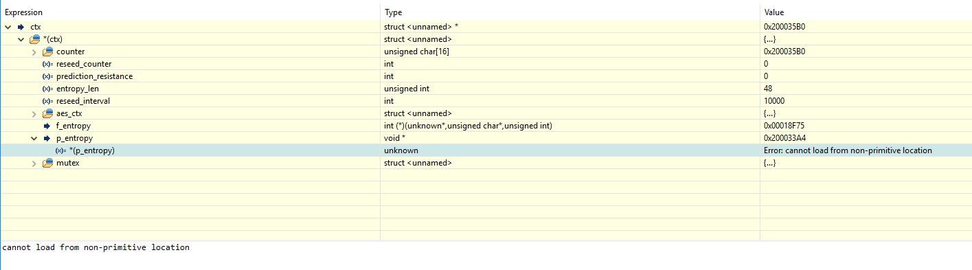

  • Hi Todd,
    I did use breakpoints and I can see that int mbedtls_ctr_drbg_reseed() function in ctr_drbg is causing that epression.
    if( 0 != ctx->f_entropy( ctx->p_entropy, seed,
    ctx->entropy_len ) )
    return( MBEDTLS_ERR_CTR_DRBG_ENTROPY_SOURCE_FAILED );
    this is the line of code that gives me that exception.
    When I hover the cursor over the ctx I can see that p_entropy is not getting loaded. Can that be a reason to cause that bus fault?
  • p_entropy is defined as a void * so it cannot be decoded in the expressions browser (note "void *" in the Type column). You need to cast it accordingly or look at in a memory browser.
    Todd
  • hi Todd,
    I used Disassembly to step over through the code and I can see that pthread_mutex_lock function is causing this error.
    For this project I used the "C:\ti\simplelink_msp432e4_sdk_3_20_00_10\source\third_party\mbedtls\ti\lib\ccs\m4f\mbedtls.a" linker file to link the mbedTLS to my project. And when I tried to build my project I was getting undefined sybol errors for pthread mutex functions and I looked up on TI website and added these two lines to my .cfg file
    var Settings = xdc.useModule('ti.sysbios.posix.Settings');
    Settings.supportsMutexPriority = true;
    After adding these lines I was able to build my project successfully.
    But still due to pthread_mutex_lock function I'm getting an exception error.
    Do I need to change something in my .cfg file or add or remove something?
    I'm attaching my .cfg file here.
