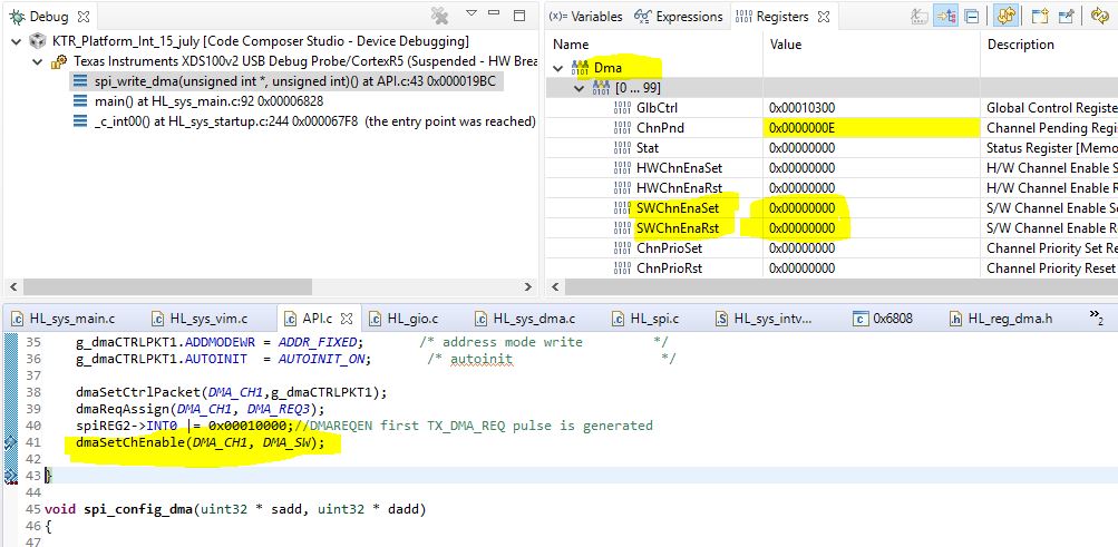

I am working on the SPI-DMA Communication. in the hardware triggering method i could able to set the HWCHENAS bit for the respective channel, but facing the issue for the SWCHENAS.
Here i have attached the snapshot for the same.
Here you can see, though after the execution for enabling the channel for the SW trigger, still the bit is not setting it up.
where dmaSetChEnable() defined as:
if(type == DMA_HW)
dmaREG->HWCHENAS = (uint32)1U << channel;
else
dmaREG->SWCHENAS = (uint32)1U << channel;
Please help me in this issue.

  • Hello Shivam,
    The SWCHENA bit is automatically cleared when:
    1. A bus error is detected (BERFLG register)
    2. A transaction parity error occurs

  • Hi Wang,
    During this Process i can see the TEREvtCtrl register is reading the data as Ah.
    It means that transaction error event has occured, how can i get away with it?
    Can you please explain me what all are the steps needed to work with SW triggering? as it is working with the HW triggering method for me but not for the SW.
