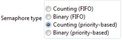

In the Semaphore type configuration you can try the counting (priority-based). If two threads are sharing a priority-based semaphore, the higher priority thread will go to the head of the priority quie when it pends - thus getting the semaphore first when it is produced by the Hwi.

Yes, "priority inversion" is possible with Mailboxes. Mailboxes are a first-come, first-served resource, no matter the priority of the Tasks. If a low priority Task blocks waiting for the Mailbox resource and a high priority Task then does the same, the low priority Task will be readied when the Mailbox resource becomes available and the high priority Task will continue to wait for the next available resource. Internally, Mailboxes use Semaphores to control access, but SYS/BIOS does not offer the priority-based use of Semaphores within Mailboxes, that Charles pointed out.
