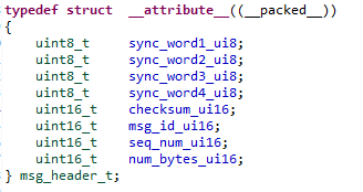

  • The synchronization I am referring to is a packet header of my own creation which has 4 sync words at the start. The GUI reads in the packet and looks at the first 4 bytes to see if they are Sync_words. I am using the internal USB controler, I have no external PHY.
    My setup:

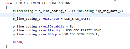

    I have a composite DFU/CDC device. The CDC is setup for
      Note: Baud=3686400
    Then each message I generate has a msg_header at the start.
