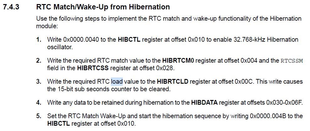

  • Hi Liguo,
      I don't see you configure the hibernate clock source by calling
    HibernateClockConfig(HIBERNATE_OSC_LOWDRIVE);
    This may be the reason that your device is locked. The device tries to go into hibernate mode without the 32kHz crystal enabled. Since the RTC clock is not running without a crystal, there is never a RTC wakeup. The device is forever in hibernate. If you want to go into hibernate mode then you need to enable the external 32KHz crystal. See the below snippet of code presented in the Peripheral Driver Library user's guide.. You can also reference the similar example code in <TivaWare_Installation>/examples/boards/dk-tm4c123g/hibernate/hibernate.c

    Below steps are mentioned in the datasheet to enter the hibernate mode.

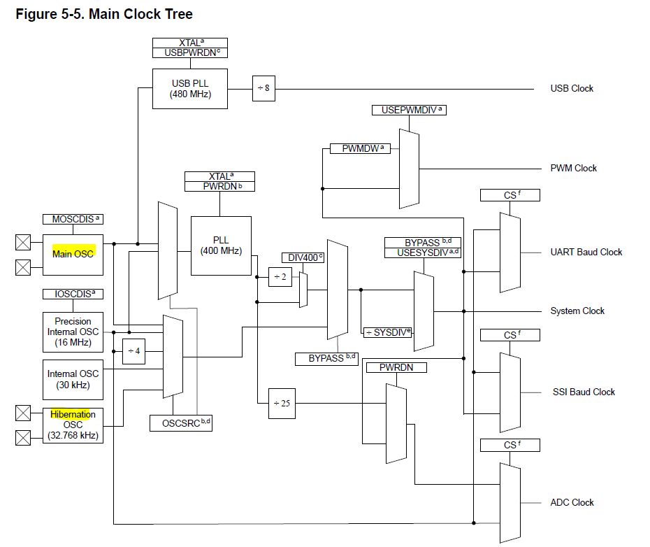

  • Hi Liguo,
      The 16MHz is the "main" crystal connected to the OSC0, not the XOSC0. The main crystal can be the clock source for the entire device. It is also used as the source for the on-chip PLL for which you can select as a clock source running at higher frequency (i.e. 80MHz) The XOSC0 needs to be connected to either a 32kHz crystal or a 32kHz clock. On your launchpad there is the 32kHz crystal connected to the XOSC0 and therefore you need to enable the 32kHz oscillator. If you directly feed an external 32kHz oscillator clock into the XOSC (this may be the case if you have your custom board) then you can bypass or disable the 32kHz oscillator.
