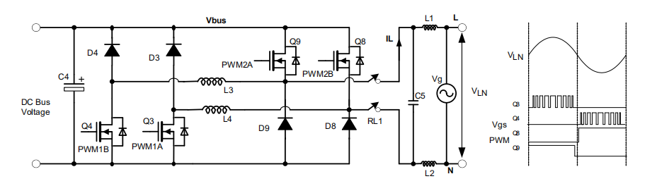

    I want to achieve a modulation like this(chopper),could you help me think of it.  I don't kown how to achieve it in my board.

    (2)And Bob,I find a example(C:\ti\controlSUITE\development_kits\TMDSSOLARUINVKIT_v100\Docs) in Controlsuite
    (I know it is not for tm4c,but i want to try how to achieve its function in tm4c,you know i am running for a competetion),
    which is tend to control the mosfet using PWM,I need to produce 4 channels PWM Wave in the right of the  picture  above
    first ,I need a  Complementary pWM wave,its frequency is 50Hz,  I can use 16Mhz/5/64000 to get it,or use timer(but no dead band).
    it's easy for me now,
    But I don't know how to produce the other two pWM,you see,the half cycle is SPWM, and the other is off,
    Bob,you are more experienced ,can you guide me to achieve it.
