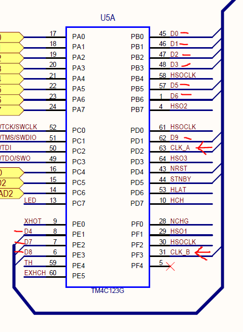

I am trying to synthesize two analog waveforms in the same time with dual 10bit paralell DAC connected to my TIVA microcontroller pins as shown on the picture below:
The period of the waveforms shall be 55 us so I decided to use uDMA for that work. I want to configure the uDMA channels (14,2,4,6) to write data from the memory to the specified ports (B, E, D, F). The TIMER 2 and TIMER 3 moduls should trigger the uDMA channels very oftenb with the following sequence: CH14 - > CH2 -> CH4 -> CH6. The problem starts, when I decrease the timers preloaded values under ~30. Then my signals are falling apart. At the end, I want to setup the timers to generate uDMA event in every few clock cycles. Can you please help me? What am I doing wrong?

  • I suspect that 30 cycles at 80MHz is not enough cycles for the uDMA to have four channels reading from flash and the CPU executing from flash. Remember that at 80MHz each discrete access is two cycles. The CPU always takes priority over the uDMA.
  • Thank you Bob, but I think, my output state variables are stored in the RAM, not in the flash. (I am using "static unsigned int") Am I right?
    Péter
  • You are absolutely correct. Last night I read static and thought const. My bad.
    I still think you may be reaching the limits of the uDMA throughput. The uDMA is a state-machine and will not be able to do transfers every cycle. Look at the time between pin writes off of the same timer trigger. I expect it will be about 8 cycles.
  • Thank you Bob, I understand that the speed I want from the uDMA is unreachable. I solved the problem with other way. (Hard-coded the GPIO write instructions in a cycle). That is not an elegant solution, but it works: With 1st optimization level, the analog signals are fast enough.
    I have other questions if I may: With my solution, I am using the 100% of my CPU in most of the time, when the signals are synthesizing, so I shall use the uDMA  to fill three of my SSI peripherals. The concept is the following: PORTA is used as an 8bit parallel interface with one clock signal on PC4 pin. I should transfer the parallel data with that sequence:
    1.clk PORTA ->SSI3TXreg
    2.clk PORTA ->SSI2TXreg
    3.clk PORTA -> SSI1TXreg
    4.clk PORTA -> SSI3TXreg
    5.clk PORTA -> SSI2TXreg
    6clk...147clk...
    Questions: I did not find any information, if the uDMA can transfer from one peripheral to another one, or just to the SRAM? I don't have a lot of experience with the uDMA, so if someone would help me to solve this problem, I would be very grateful.
    Péter
  • Wow, if you are that near 100% CPU already, it will be tricky. The datasheet only advertises memory to peripheral and peripheral to memory.That makes sense since most peripheral transfers are done when the peripheral sends a request.  I don't know what will happen if you use UDMA_CH6_GPIOC for the uDMA request and just use the address of the SSIxDR as the destination. You will have to make sure that you don't overflow the SSI TX FIFOs. You would use Peripheral Scatter-Gather mode.
