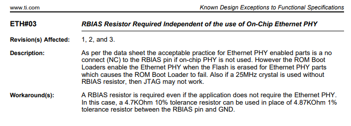

  • Try adding the 4.7K Ohm resistor from RBIAS to ground. This is described in the errata document as advisory ETH#03.
  • Hii Bob Crosby
    I have connected the 4.87K register at RBIAS and 10 K Pull up on Reset pin.

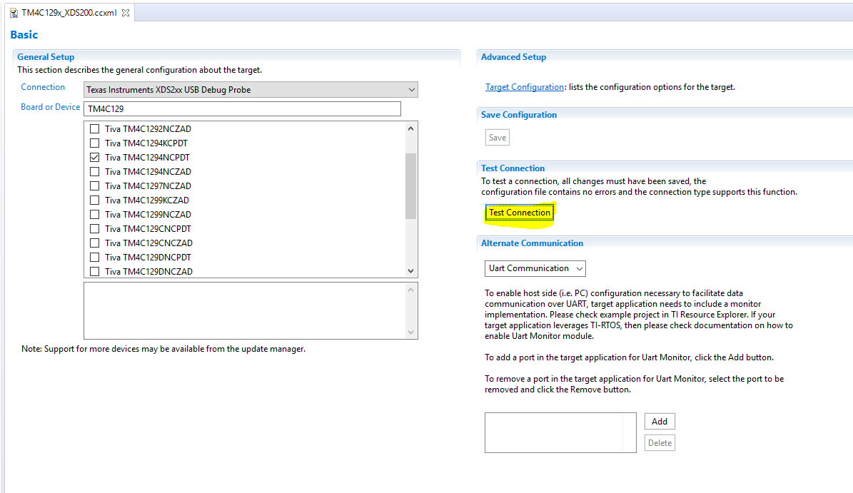

  • Have you tried using the JTAG test function in Code Composer Studio? If that fails, look for a hardware issue. Without launching your target configuration, open it in CCS and you should see the "Test Connection" button.
  • Hii Bob Crosby
    Sir , kindly go through the below Test connection file. there it's showing IR and DR test succeeded.
    In first conversation of thread already i have shared the schematics of customized pcb of tm4c1294ncpdt.
    kindly go through that schematics and let me know if there is any changes.

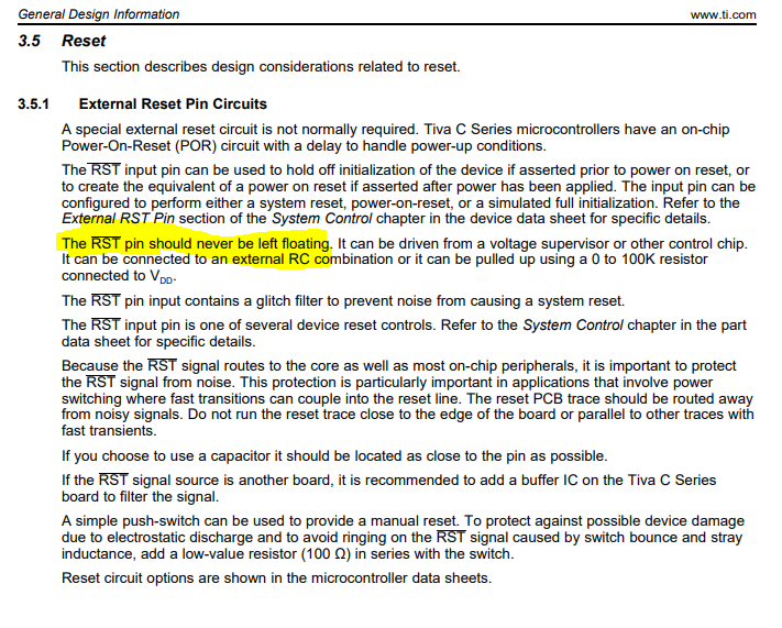

  • It looks like the JTAG signals are good. Check the voltage on the RST pin. You should add a pullup resistor.
  • Hii Bob Crosby
    I have already connected the pull up resistor at RST pin.
    Problem is occurring due to  25 MHz crystal, that crystal is not working.
    Now the board is working fine.
