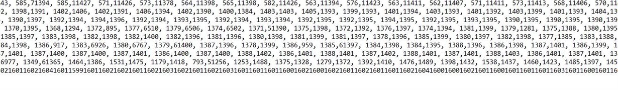

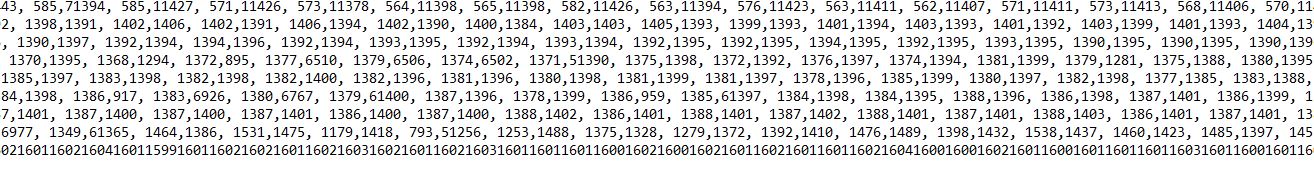

I am making a data logger where i store ma values from my accelerosensor( X,Y and Z)  to a sd card.
I already solved some issues, but now i have a issue with ghost value. When i read de data that are stored in the SD card, they dont match with the real data and random number are added to it.
I should have values between 0 and 2000. but sometimes I even got values of 110000. Could someone help me with this please?
Also It does not print in a new line after the 3 values are printen. I tought "\r\n" was the correct syntax?

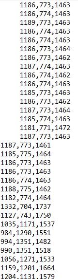

    • Top line data (first 30 data points) reveals 'illegal data' (data > 2000) alternating w/(assumed) legal data.  (0 ≤ data < 2001)   Is not that 'alternation' - of any interest?   (report was silent in that regard)
    • Second & third lines of data appear legal.    Why is that - what had changed?   (those are useful facts - are they not?)
    • Fourth line data reveals '4 clustered illegal values' - remaining appear legal.   Again - what has changed?
    • Your narrative and code indicate your capture of 3 sensor channels.  (X,Y,Z)   Yet - most of the data presented - due to the 'data patterns' - appears to be confined to 'Two Data Channels.'
    Report here should prove of some value/guidance in enabling (your) further analysis.   I'd slow the transfer speed between MCU & SD Card - at least during your initial investigation.   Give your system 'Every chance to succeed' - attempt to 'Break Land Speed records' only later...   (maybe)
  • Your string may be too small to contain the three values, commas the \r\n and a null character. You only allocated 10 characters.
    I increased the length of my string and it partially solved my issues. My first line is good, but from the second line on, it leaves a few empty spaces and only start printing after the empty spaces.
    It looks like I coded some empy places after the \r\n.
    Could you see where i'm wrong in this line ?
    sprintf(strValue,"%d,%d,%d\r\n",valueX,valueY,valueZ);
  • I don't think the problem is with your sprintf(). In line 100 you have:
                    iFResult = f_write(&fil, &strValue,4, &count);
    The third argument in the call to f_write() is the number of bytes to write. You specified 4. Therefore only the first 4 characters of the string "strValue" will be written. What I think you want is:
                    sprintf(strValue,"%d, %d,%d\r\n",valueX,valueY,valueZ);
                    iFResult = f_write(&fil, strValue, strlen(strValue), &count);
  • First of all, thanks a lot for your help!
    It kinda solved my problem toon but now I have something weird. There is still empty places in the first lines, but after a couples lines it dissapear.
  • I am not sure why you have the blank or tab characters at the beginning of those lines. Your code is always appending. Could those lines be from a previous attempt? I also see that you call f_mount() outside of the while loop (line 74) and then inside the loop call f_open() (line 78) and f_seek() (line 79). You then call f_mount(), f_open() and f_seek() again (lines 95-97).  I suggest you remove the redundant f_mount(), f_open() and f_seek() (lines 95-97).
