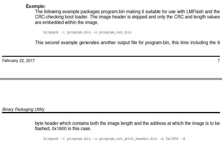

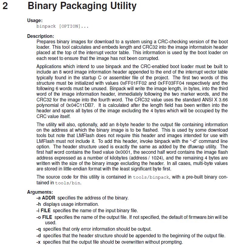

  • Thank you charles,
    First of all thank you very much for fast response.
    The process of enabling runtime CRC Checking is good option to solve my purpose but i need to understand the whole process implementation,
    If some document describe it step wise, or some reference describe it step wise  will be greatful.
    Also clear the process and want to know about tools/binpack.exe.
      Please reference the TivaWare Host Tools user's guide under <TivaWare_Installation>/docs/SW-TM4C-TOOLS-UG-2.1.4.178.pdf about the usage of binpack.exe. Below is what is described in the user's guide.
