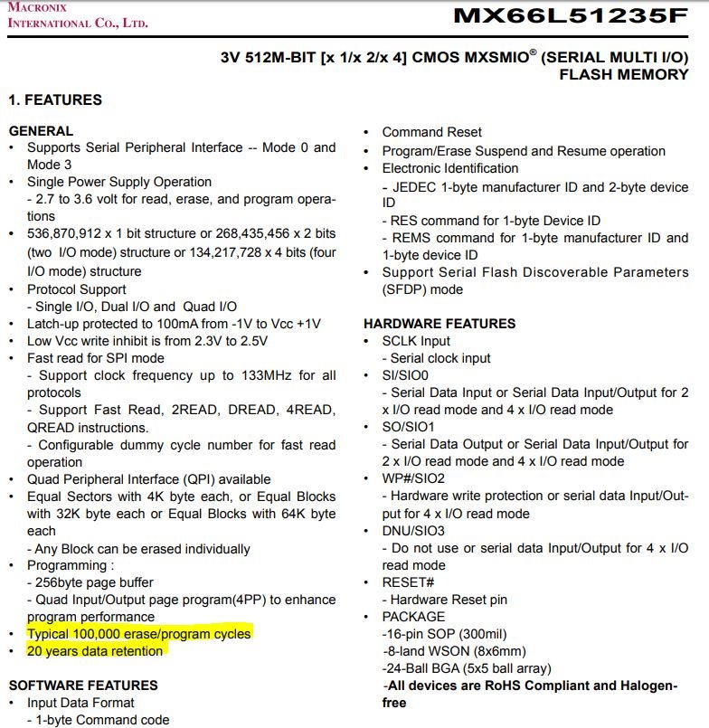

The SD card can be formatted to fat file system. So, both hardware are tested. SD Card is tested with fatFs and qssi is tested with the original example.
My goal is use FatFs on QSSI flash memory.
If I use the fatfs example but with jumper position on qssi on boosterpack, the fatfs can not created.
Can you please help me how can I use SDSPI_fxn functions to work with QSSI Flash memory? As I saw, SDSPI_ is used to interface with external storage.
Thank you for your help!
  • Hi Daniel,
      I don't think the TI-RTOS supports the QSSI "advanced" mode. Perhaps that is the problem. Below please find a simple example that uses QSSI advanced mode. Look for the SSIAdvModeSet() API call. I will also suggest you look through the ektm4c129_qssi_example code that you pointed out and search how the advanced mode API is called and used to interface with the external QSSI flash. With that, I hope you can adapt to the TI-RTOS SDSPI.  I think you are the first person I'm aware to ask question about interfacing the TIDM-TM4C129SDRAMNVM using TI-RTOS. If you can get it to work with TI-RTOS please do share with the community. It will great benefit the community who are looking for the same solution in the future.

    Thank you for your detailed reply. Before I start the work, let me tell you the application that I would like to complete. Maybe you have a much better solution / advice.
    We are using TM4C129ENCPDT in production with external EPI RAM that you can find on the booster back mentioned in my first post in our custom desing. It works flawlessly, however the application needs to save the last N acquired samples continuously into a NVM to keep this data for the next boot.
    My first thought was to use FatFs for storing sampled data and the booster pack: TIDM-TM4C129SDRAMNVM came into my mind. I could make the SD Card work but we dont want to use SDCard becase of the the fact that, users can not access to SD Cards because of the housing. So there is no need for removable NVM. The booster pack has QSSI, soldered onto the pcb so it is an obvious choice. Unfortunately, the SDSPI_fxn calls failed thats why I started this topic.
    Right now, I am a little bit worried about the type of NVM. What is the expected lifetime (number of writes) does this NVM has? We need to make this NVM work for a long time. Should we use eMMC instead? We need to be compatible with TM4C and MSP432E.
    Any idea?
    PS: If I implement the QSSI I will post it.
  • Hi Daniel,
      I found in the BOM list the 512Mb is a Macronix Quad SPI Serial Flash. The link to the datasheet is provided below.
    The write cycle is specified to 100,000 cycles. Is this enough for you? You will need to do some Google searching, try Digikey or Mouser for NVM if your application requires more write cycles.
     Again, please do share with us how you get it to work using TI-RTOS SDSPI driver in Advanced QSSI mode. I will close the thread for now. But you can always reopen by posting to this thread when you have something to share.
