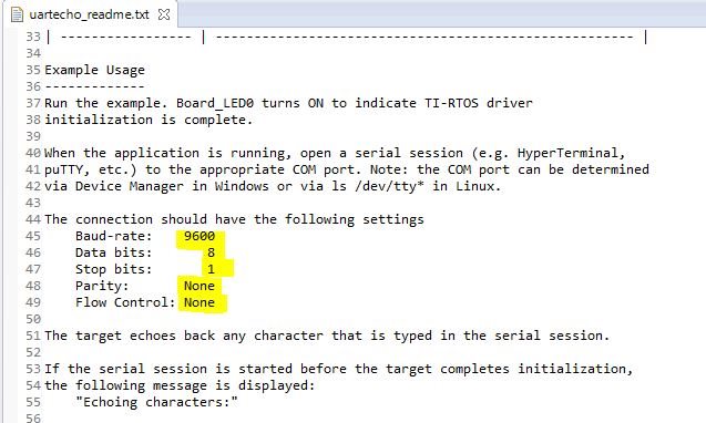

  • Hi Suresh,
      Are you running the TI-RTOS example? If yes, there is a uartecho_readme.txt file in the project directory. Below is the excerpt. You need to open a terminal window such as hyperterminal or you can use the CCS built-in terminal window. Configure your terminal window with the matching connection setting such as the baud rate, data bits and etc. The echo example is meant to echo whatever is received by your UART module back to the sending host. In your terminal window you just type something. These characters are then sent to the MCU and the MCU will echo them back and this is why you see the same characters (what you type is what you see) appear in the terminal window. If you are running a TivaWare uart echo example it will be the same concept. You just need to open a terminal window. For TivaWare uart example, the baud rate is normally set to 115200 instead of 9600. So make sure you match the correct setting in the terminal window.
