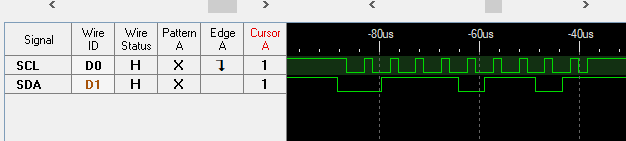

  • First let me comment that there are four I2C modules on this device. Trying to create a fifth by bit-banging is a bit unique, and not very CPU efficient.
    Second, we strongly advise against doing direct register writes like you have in the code you posted above. The TivaWare library provides proven functions that greatly simply the pin configuration you are trying to do. Using the library functions will increase your productivity and make it much easier for anyone on the forum to understand and help you.
    Here is an example:

  • Hi Bob,
    Thank you for the help!
    Ya I know that there are I2C modules present in the TM4C123GH6PM MCU. I am new to TIVA Series MCUs and I was trying to be familiar with GPIO configurations. So thought of implementing I2C using GPIOs.
    Sure, I will refer tivaware libraries in future.
    As suggested by you, I configured SDA and SCL pins (being used for bi-banged I2C) as below,
    1. SDA & SCL as open drive outputs.
    2. SDA & SCL direction as Output.
    3. DEN (Digital Enable) register values reset to 0.
    With the above configuration, I could write the DATA to I2C Slave and could not read from Slave (reading as all bits as "1" ). So, during READ operation, I changed the Direction of SDA as INPUT to read the data from Slave. I hope that is OK.
    Now, I can do Master TX -> Slave RX and Master RX -> Slave TX, both operations.
    Thank you for the kind help.
