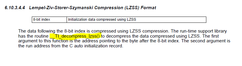

There is a decompression routine in the run time support library, __TI_decompress_lzss(), that is used for initialization. See page 162 of the Compiler User's Guide.
