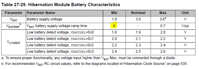

Hi, I am trying to find out what the maximum turn on time allowed for the TM4C1294NCPDT for VDD, VDDA, and VBAT?
Thanks!

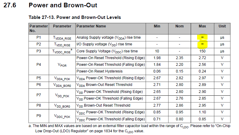

  • By "maximum turn on time" do you mean a minimum voltage ramp time? If so, there is none.
  • Greetings - and like you - team here thought of  'Rising, Voltage Ramps.'
    However - might the 'Power/Voltage Sequencing' better represent this poster's question?     Our belief - gleaned from many MCUs (over past 25+ years) and five different ARM MCU Vendors (over the past ten years) reveals:
    • VDD should be first to arrive in 'full force' (i.e. to spec) ... even though - especially though - the capacitive load upon VDD is highest.
    • VDDA  (when independent from VDD) should arrive only AFTER VDD has reached its specified level.   (that's our firm's well experienced/documented belief)   The MCU was never intended to be (majority) powered by VDDA!    Repeatedly we have observed this as a 'certified MCU Killer' - across a variety of MCU Vendors!
    Special circuit design IS normally required - if/when VDDA is not directly derived (or tied) to VDD.   (this so VDDA does not 'lead' VDD in reaching spec.)
    Joining VDDA to VDD 'solves' the 'power sequencing' issue - yet compromises most all of the MCU's analog features.    (Digging beneath the surface (as illustrated here) - reveals not always - the most pleasant of pictures.)    And all MCU Vendors 'share' this vulnerability' - and choose to then, 'deal with or avoid' - as is their (usual) custom/practice...
