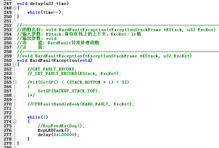

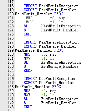

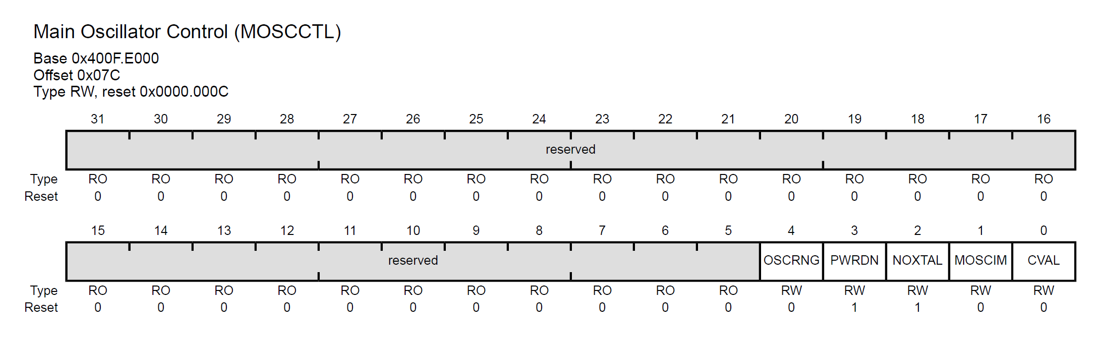

1、Detect the register MOSCCTL (I don't set any bit of it), when the code is running, the bit OSCRNG(High Frequency Range (equal to or greater than 10 MHz).) was 1 when the rest were 0. After I cut off the external oscillator, the code jump into Hard_fault handler automatically and register MOSCCTL didn't has any changes.
2、When I used j-link simulator to simulate the MCU, I cut off the external oscillator. In most case, the code will jump to Hard_Fault Handler, but sometimes it will jump to bus_fault or memery_fault. What's more, when code jump into hard_fault handler, it need me to click single step run the code, it can't run in full speed and sometimes it even didn't run and register PC  didn't count when I click single step. So it 's difficult to me to judge whether the MCU was still working.

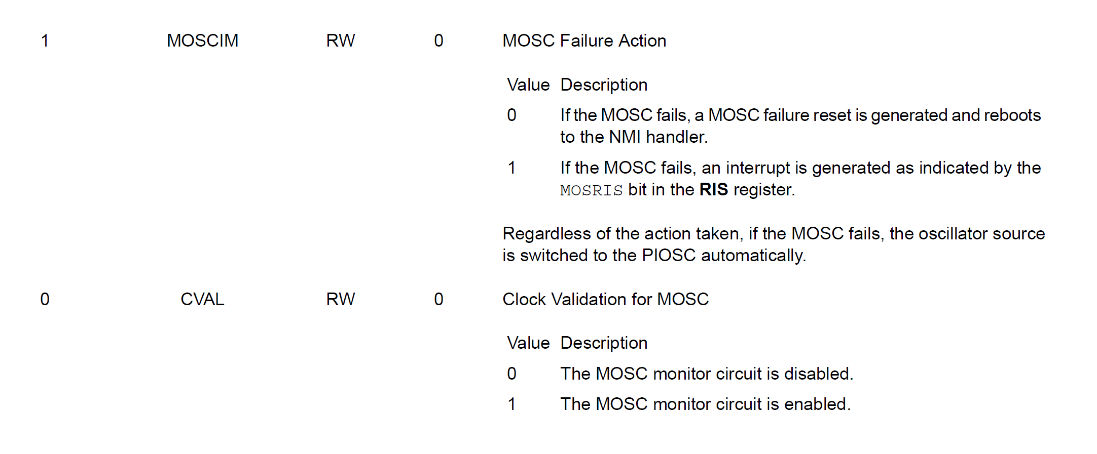

  • First did you enable the main oscillator monitor (CVAL bit of MOSCCTL register)? Did you select the interrupt or NMI on oscillator fault (MOSCIM bit)? Did you configure the NMI or interrupt routine?

    I'm sorry for replying you so late because I have another emergency issue need to fixed. I decide to active clock detection circuit , if external oscillator  failed,bit MOSCPUPIM in register IMC will be set, after the MCU reboot, I will select the internal oscillator as clock source according to the bit MOSCPUPIM when the  MCU is at initial state and set a warning to remind user external ocillator doesm't work now.
