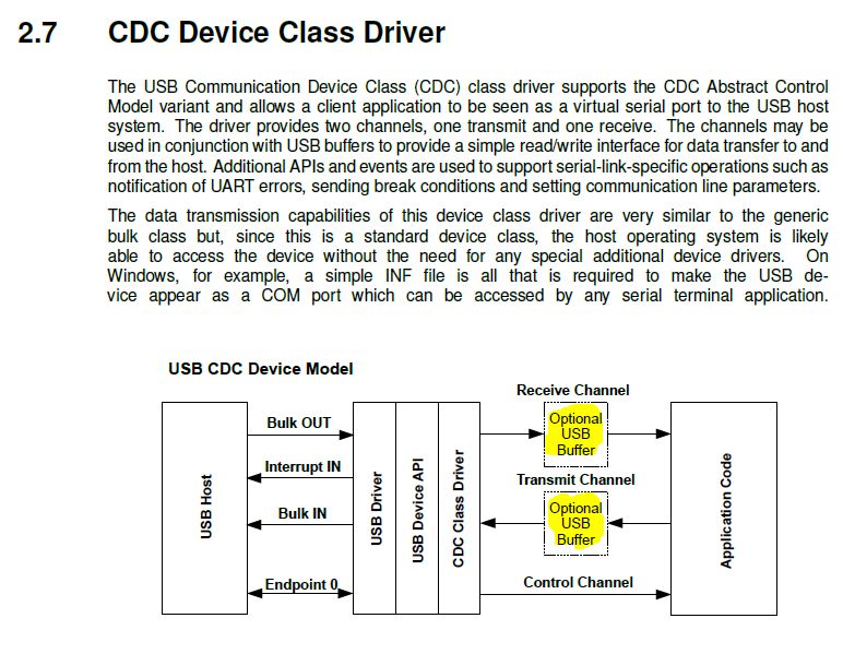

    Doing the wireshark sessions is the correct approach. Since they are not showing any error and since this issue occurs as the optimization is set to faster execution, I suspect that it is a data overflow problem that PuTTY is not handling well. Did you include the optional USB buffers in your implementation?

  • What do you mean by "optional USB buffers"? It doesn't ring a bell to me at this point
  • I assumed you were using the CDC Device Class Driver from the TivaWare usblib. The document is in the TivaWare directory:
    C:\ti\TivaWare_C_Series-2.1.4.178\docs\SW-TM4C-USBL-UG-2.1.4.178.pdf
    Here is the block diagram:
    An example of using the buffers in in the file
    C:\ti\TivaWare_C_Series-2.1.4.178\examples\boards\ek-tm4c1294xl\usb_dev_cserial\usb_structs.c
