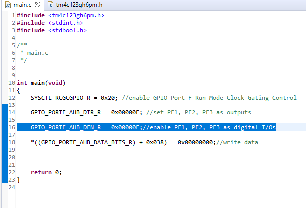

I tried to do the "direct register access model" programming on the "TM4C123G LaunchPad" through ccs, but met a problem at the beginning.

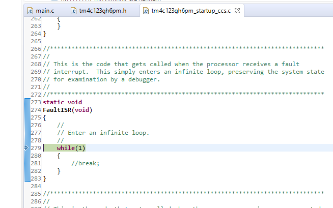

As showed in the image blow left, there are simple codes to configure the PF1/PF2/PF3 as output and set their value as 0. While debugging when i am trying to "step over" the highlight step, the program will run into the "fault while loop". I do not know why this would happen. Could you help to provide some instruction/comments on it. Thanks.
    Diagnosing Software Faults in Stellaris® Microcontrollers has guidance on debugging the cause of faults. While the document was written for Stellaris devices, it also applies to Tiva devices.
    Section 5.2.6 System Control of the TM4C123GH6PM datasheet contains:
    There must be a delay of 3 system clocks after a peripheral module clock is enabled in the RCGC register before any module registers are accessed.
    There is no such delay in the example code, and so the fault could be due to an attempt to access the peripheral before it is ready. Rather than inserting a fixed delay, you can instead poll the General-Purpose Input/Output Peripheral Ready (PRGPIO) to determine when the GPIO Port F is ready.
    Also, what is the reason for needing to use the "direct register access model" rather than TivaWare?

    Thanks a lot for your reply. Now the problem is solved through adding the status checking code.
