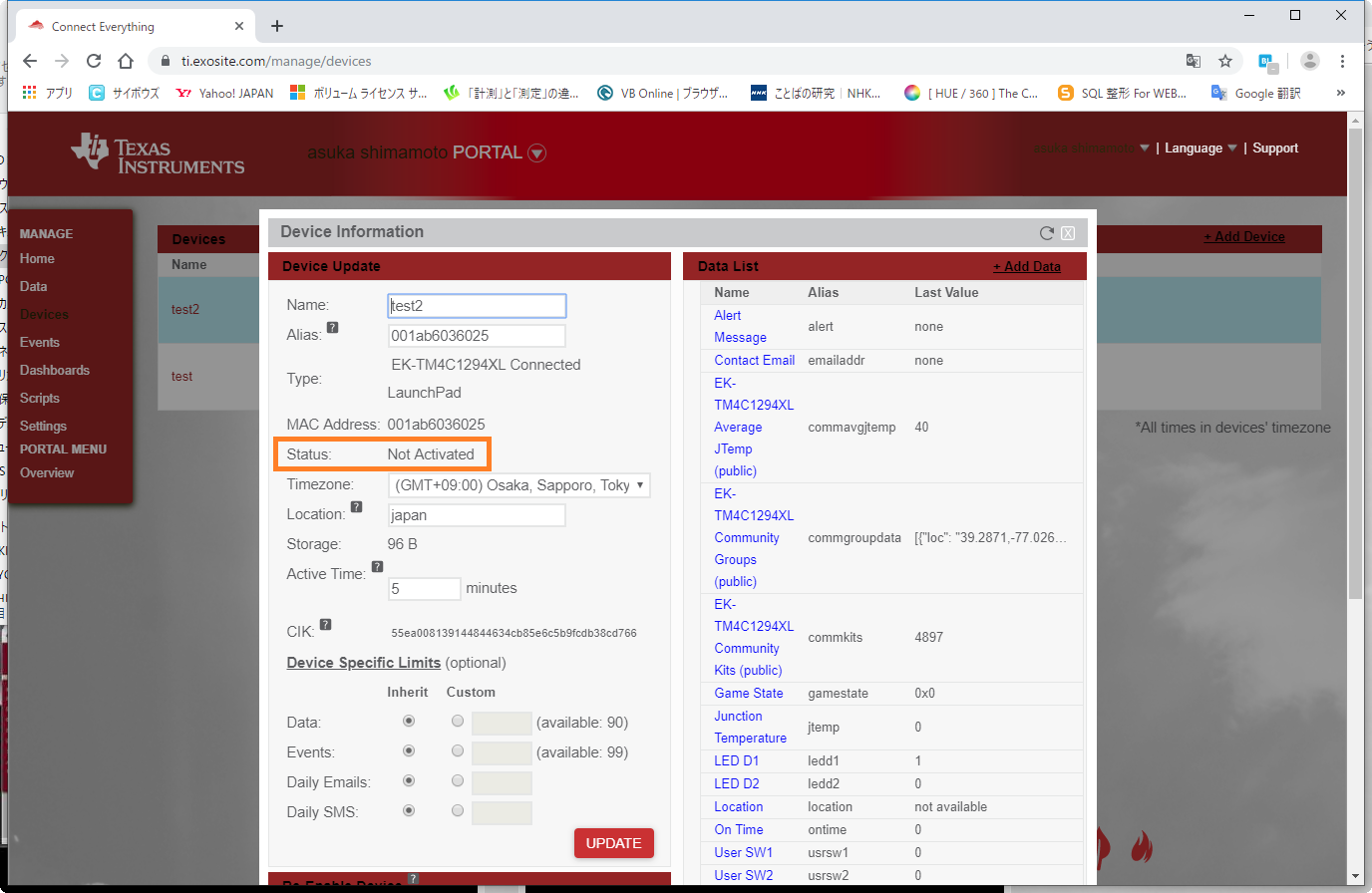

Hello.
(I'm a Japanese, so I'm not good at English.
Sorry if the text is difficult to understand. )

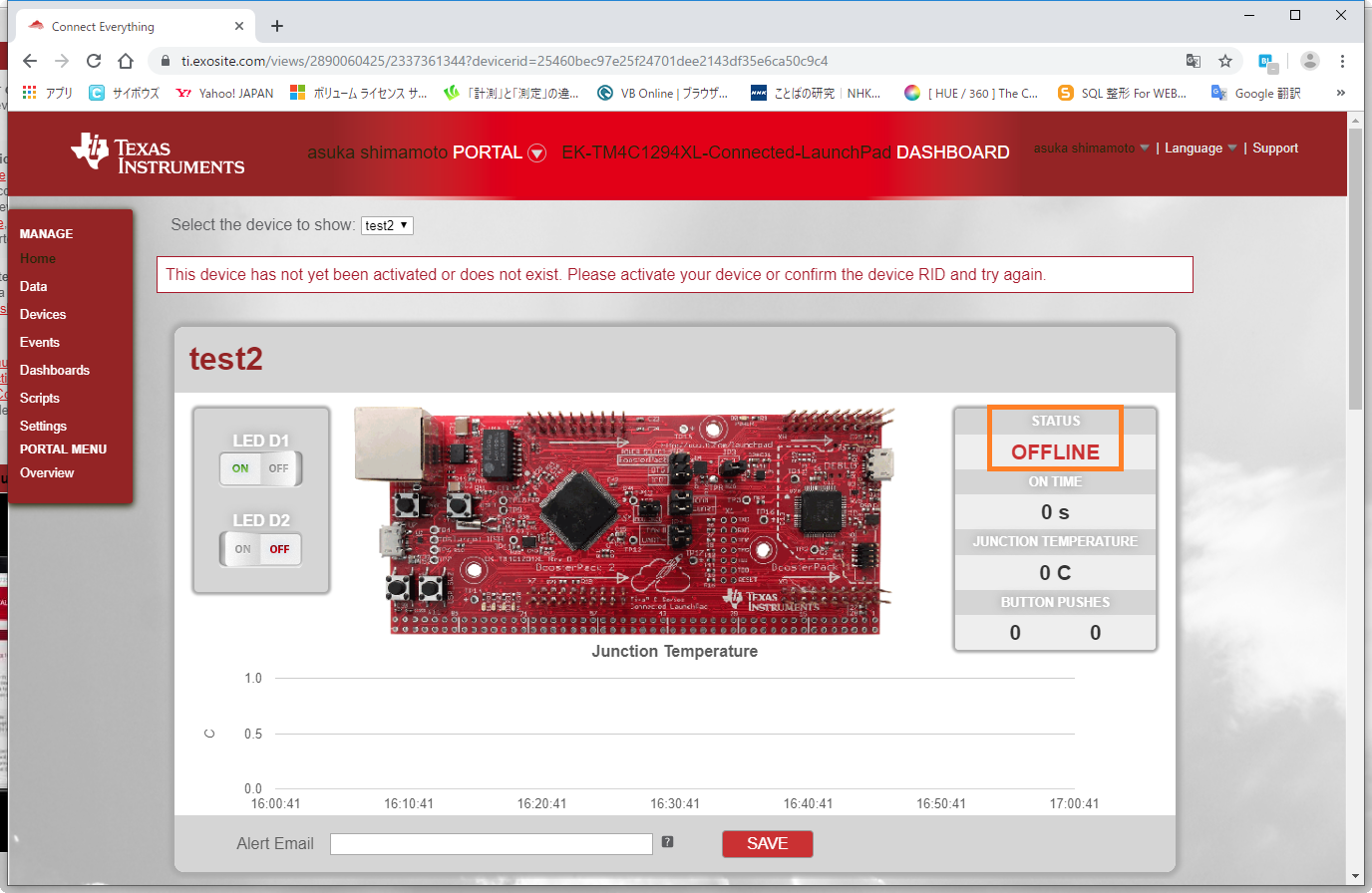

What's in trouble:
“Status: Not Activated” and “OFFLINE” cannot be resolved.
environment:
windows10 64bit
I was reading and working on the board manual, but I had a problem. Then I checked the troubleshooting.
community.exosite.com/.../24
I confirmed that the MAC address is correct.
I don't know how to use "virtual COM port debug console", so I can't check if an IP address is assigned.
Could you tell me how to run "virtual COM port debug console" or other communication check methods?
thank you for reading.

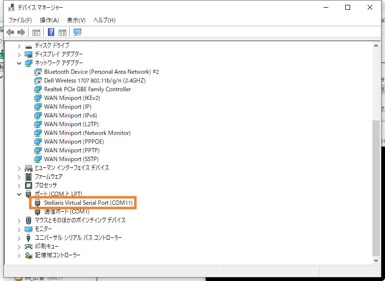

    The LaunchPad can connect to a Terminal port software such as TeraTerm, Docklight, PuTTy, or Termite in order to output debug information you can read on your screen. Make sure to use setting 115200 Baud 8N1 when making the connection.
    To connect to the right port, you should open Device Manager and under Ports you should see a port such as "Stellaris Virtual Serial Port". You would select that one to connect to with your Terminal software.

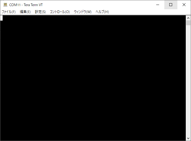

    I did it using TeraTerm as you taught me, but it doesn't respond.
    I typed enter, but the screen is black and nothing appears.

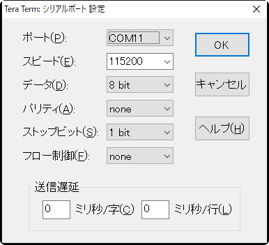

    <Device manager>
    <Serial Port Setting>
    port: COM11
    baud rate: 115200
    data : 8bit
    parity: none
    stop bit: 1bit
    Flow control: none
  • Hello Asuka-san,
    When you have the terminal connected, can you reset the board and see if you get any output on it?
    If I remember TeraTerm right, it does not display what you type on the screen, so you won't see any display except what the LaunchPad sends. Usually programs that use the UART console will send a welcome message when they start up so you can be sure it is connected. So resetting the LaunchPad should help show that.
    You also can check if a terminal is working by loading a TivaWare example project like 'hello' to see if you get the output. This would be a simple way to make sure at least the board and your terminal are working together. If that works, then the issue could be with the exosite project itself.
    If TeraTerm doesn't work, you may want to try one of the others. Honestly I use Termite almost exclusively myself, so I don't have much experience with the others.

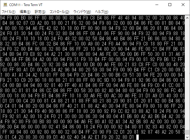

    After setting up TeraTerm, I pressed the reset button on the board, but it was not displayed anything.
    sample 1st: EK_TM4C1294XL-> Driver example-> UART example-> UART example
    When this sample was debugged, binary data was displayed in TeraTerm.
    A message that appears to be a welcome message was not displayed.

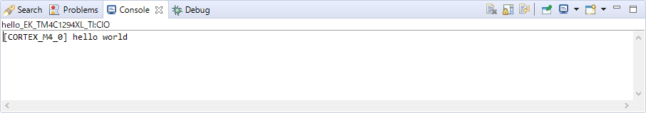

    sample 2nd: EK_TM4C1294XL-> Driver example-> Kernel example-> Hello example
    When this sample was debugged, it was output to the CCS terminal.
    It looks like the TI-RTOS examples use 9600 baud instead of 115200, try that and see if TeraTerm works better.
    The Exosite example stated this though: Once installed you can connect a terminal application to the COM port running at 115,200 baud, 8-N-1.
    So you will need to use 115200 with the Exosite example after verifying the UART console example from TI-RTOS at 9600.

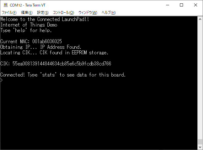

    However, I have an board of the same type.
    When I tried there, it operated normally.
    If possible, Please tell me a way to get a IP address using debug console?
