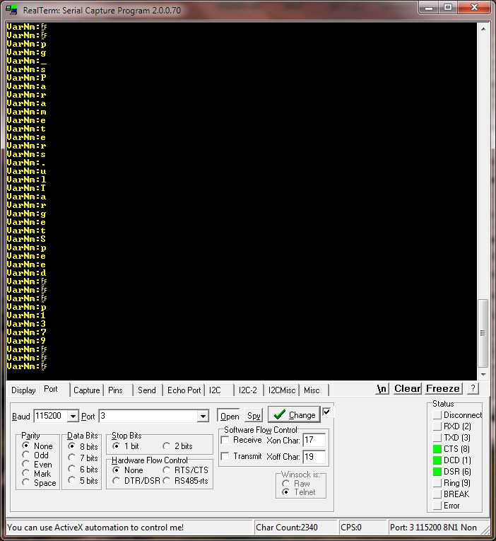

    Thanks for getting me to think outside the box on how to get robust UART transfers. Testing 2 dim array below with UartGetNonBlocking() POP for 7/8 full FIFO interrupt, seemingly occurs via one interrupt loop. At least the UARTprintf(0) of UART2 RX data input seems to indicate multiple characters are specific to 0xFF signature being compared for print out. I used the WEB example (for int I, int j ) loop to fill the 2 dim array (16 rows, 8 columns) with FIFO read. Oddly return data from UartRxErrorGet() was always 0x0, now check variable &=0xF otherwise a constant RX error occurs for 0x0 length variable assignment. The Rx error check function also &0xF with REG2, if no error/s occurs return = 0x0.
    /* Two dimensional array 16 Rows x 8 Columns deep */
    uint8_t Cchar[16][8]={0,1,2,3,4,5,6,7,8,9,10,11,12,13,14,15,16};
    Your array sequence should properly end in '15' - not '16' - should it not?     To your (other) 'points'  -  those left for vendor crüe.    (weekend's arrival (may) be welcomed by some...)
    Which 'Web example?'     There are many...
    Can it be noted that you've regularly generated a slew of 'USB Focused Questions/Postings' - yet your 'Arduino-kick' (now) appears to have, 'Kicked USB to the curb!'
    Should not a superior thread subject be:  "USB to UART What?"     (same grammar failing continued...)
  • Web link above posted & the 16 array size don't care being simply 1 extra space, now at 256x8 makes no difference.
    It seems UART2 is not seamless to CPU directives (for/while) loops used to fill 16 or even 256 spaces during interrupt handler call to Get RX data. Somehow UART0 used to debug UART2 via report of RX data retrieved can only single step UART2 buffering RX data into multi dimensional array for 7/8 full interrupts. No other UART RX interrupt level is even possible without halting other application parts such as EMAC0 DHCP auto IP assignment. Yet the multi dimensional array is working since the variable names assigned are being printed via UART0 in single steps along with other odd symbols. Appears to be data over run but no error messages printed. The odd characters printed out were often tiny f/f indicating end of string 0xff.
    The RX data is printed but reports only bit/pieces at a time when ever an RX INT or RX timeout is forced as GUI button sends more data to target UART2.
    Later discovered a while loop not exiting for long periods of time inside INT handler causing the random FIFO loops. Oddly there were 3 breaks in various parts but that didn't matter.
