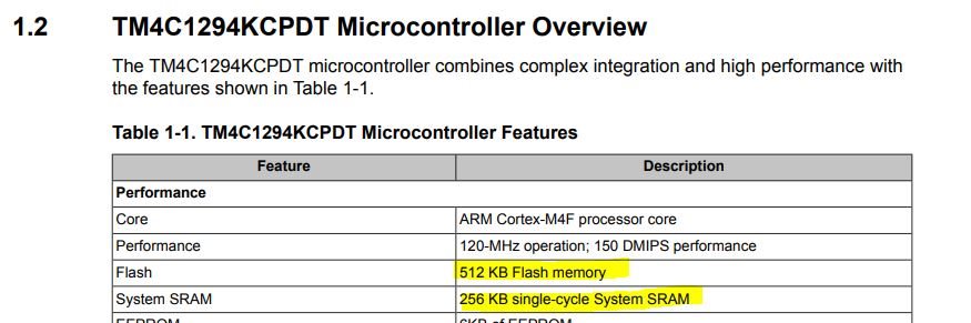

  • The TM4C1294KCPDT has the below memory size. I think if I understand the error correctly  your .bss section is 0x5d916  which is larger than 256kB. You will need to find out where in code are these uninitialized variables are and fix the problem. I will suggest you read the .map file generated by the linker output.
