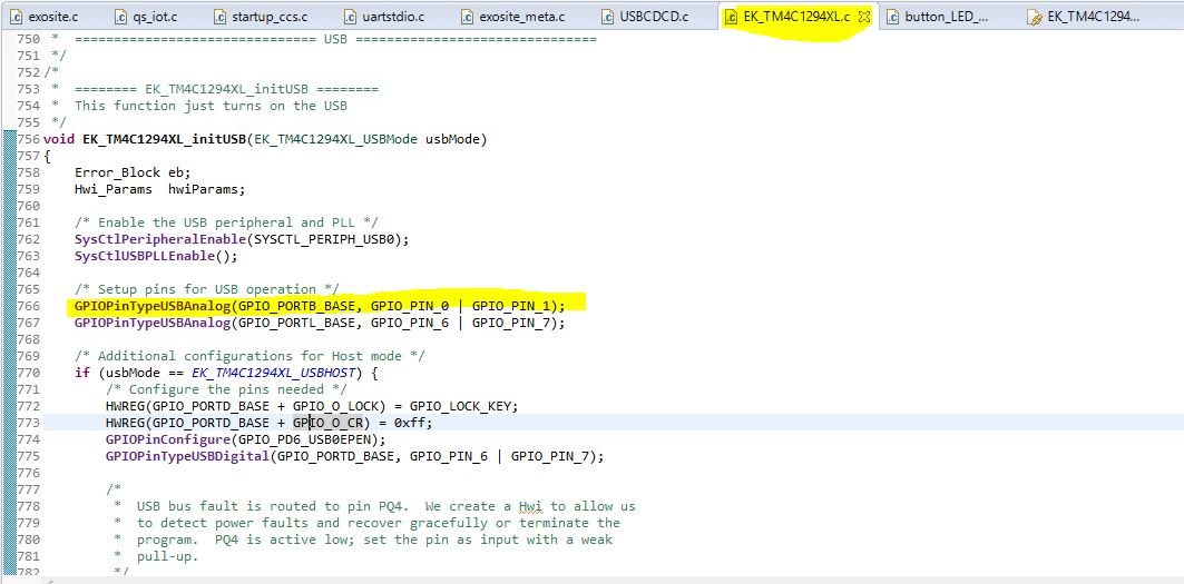

  • Hi Jay,
      In the EK_TM4C1294XL.c file of the usbserialdevice_EK_TM4C1294XL_TI example, the PB1/PB0 are already configured as VBUS/ID pins. This is what I meant they are already done in the example. If you are creating a new USB project on your own in the future, please make sure this is done so that VBUS can be monitored by the USB device.

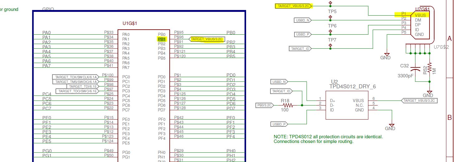

      In the launchPad the VBUS is already connected to the PB1 pn. You will need to do the same for your custom board. You can find the schematic of the LaunchPad board in the EK-TM4c1294XL User's guide. Below is the connection.

  • Hi Jay,
      Yes, your understanding is correct that you can route the VBUS input to other GPIO. Please see below note about VBUS in the TM4C129 system guideline app note. http://www.ti.com/lit/an/spma056/spma056.pdf. You can create a voltage divider to route the 5V VBUS to 3.3V GPIO input.
