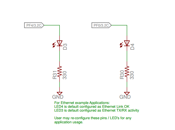

I use the  TM4C1294 Connected Launchpad (EK-TM4C1294XL) to do same experiments.
I use the FP0 and PF4 as normal output GPIOs to control D4 and D3 to on/off on, as below,

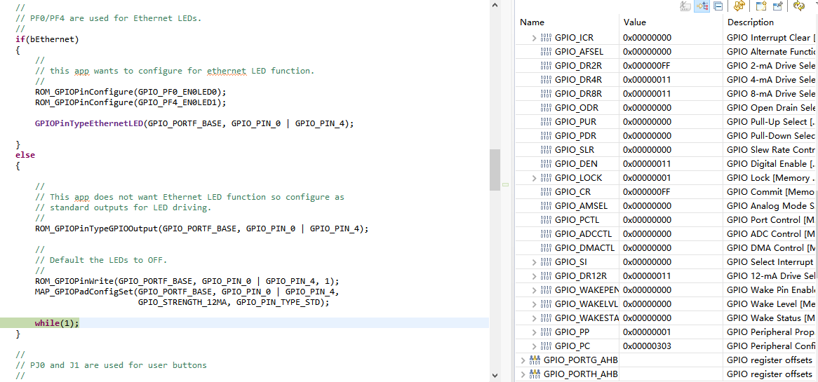

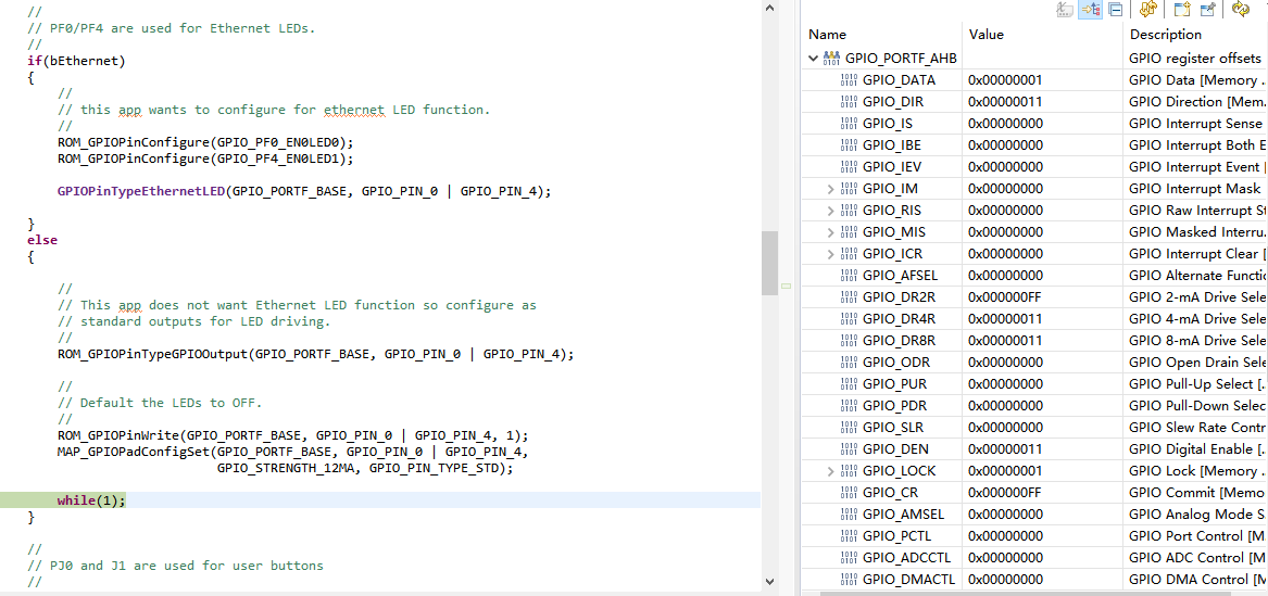

I modify the code in pinout.c, I write the PF0 and PF4 to 1, the D4 is lighting, but the D3 is not lighting, the code as below,
I read the TM4C1294 Datasheet, it is no ploblem about the code.
why the D3 is not lighting?

      You should change:
    FROM:
    ROM_GPIOPinWrite(GPIO_PORTF_BASE, GPIO_PIN_0 | GPIO_PIN_4, 1);
    TO:
    ROM_GPIOPinWrite(GPIO_PORTF_BASE, GPIO_PIN_0 | GPIO_PIN_4, GPIO_PIN_0 | GPIO_PIN_4);
    Please note that the pins are specified using a bit-packed byte. What you wrote only sets PF0, not PF4. If you want to set both PF0 and PF4 you need to write 0x11, not 0x1.
