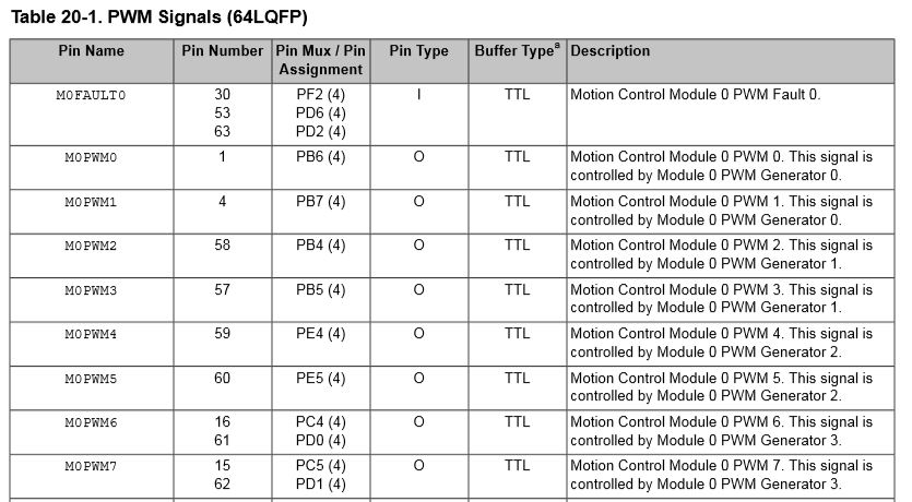

Our problem is that we can not get an output out of Pins:  61, 62, 63.
We are using a pulse-width modulator code to attempt to create a clock output.  The output should be a 0 to 3.3VDC square wave.
Pin 61 is a clock output, that output remains low.
Pin 62 and 63 also remain low.
We do have +3.3VDC at VDD and VBat pins.

  • Failure to achieve MCU pin Output usually results from:
    • incorrect pin & port initialization (to include enabling, configuring & typing)
    • selecting pins which are 'not' GPIO and/or special output function capable
    You speak of 'Pulse-Width Modulator' code.   Had you noted that only a 'small set' of the MCU's GPIO pins may serve as, 'Official PWM Output Capable' pins?    Indeed - via software - you can induce most (any) pin to perform most (any) function - yet the 'special' PWM API functions address ONLY those pins which are truly PWM Designated!
    Do pins 61, 62 & 63 meet those (strict) PWM capable requirements?

    Staff just checked - they find pins 61 & 62 to be legitimate PWM Output Capable pins.    However pin 63 is a, 'PWM Fault Input Pin' (which KILLS those PWM outputs when 'active') and thus is UNSUITABLE for your PWM Output purposes!
    Our MCU manual - page1233 - reveals MANY potential, 'PWM Capable Pins' for your selection.    Avoid any of the 'PWM Fault Pins' - those are inappropriate for your expressed usage...

    Does this mean that pin 61 can only be used as a PWM output and pin 63 can only be a PWM fault?
    I was trying to use  pins 61 and 63 as data lines (PDO and PD2 respectively), which are either a high or a low.

      The PD0 (pin61) and PD1 (pin62) on the J3 connector are connected to PB6 and PB7 respectively on the launchPad via a 0ohm resistor for some boosterpack compatibility reason. Please remove the R9 and R10 resistors. I think this is the problem. Hopefully this will resolve your problem if you are using the launchPad. If you have your custom board and still unable to generate PWM on PD0 and PD1 then it will be a different problem to investigate.

      Thank you for helping out this post. You are correct the pin63 is a fault input pin, not a PWM pin.
  • The TM4C123GH6PM IC is mounted on a custom board.
    I am using the EK-TM4C123GXL launchPad for programming the IC only.
  • Kindly review our 'Cut/Paste' from the MCU manual.
    Note that pins 61 & 62 (PD0, PD1) - either or both - may be legitimately used as PWM outputs.
    Pin 63 - as the chart shows - may only be used as PWM Fault INPUT.    You MAY 'liberate' pin 63 from its 'PWM role' - and instead employ it as a GPIO input or output...
    Neither firm nor I have used this MCU recently enough to recall if 61/62 may 'divide' between: 'Use as PWM output (1 pin) AND GPIO Output (2nd pin.)
