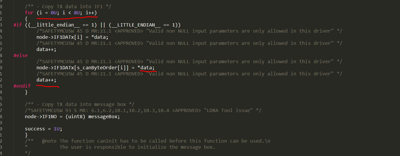

It seems that the canTransmit function always transfers 8 bytes into the IF register regardless of the data length code configured in HalCoGen. Is this intentional? This does not seem like a good idea.
    Yes, you are right. It always transfer 8 bytes data to the message object. If the data length code is less than 8 bytes, the remaining bytes of the message object is overwritten by undefined values.
    Only DLC bytes data are transmitted to the CAN bus.
