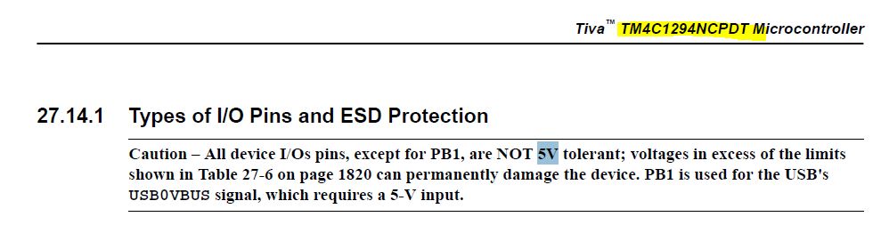

  • As in the datasheet of the controller specifies max operating voltage is 0 to 4V
    So are the GPIO pins 5V tolearnet?

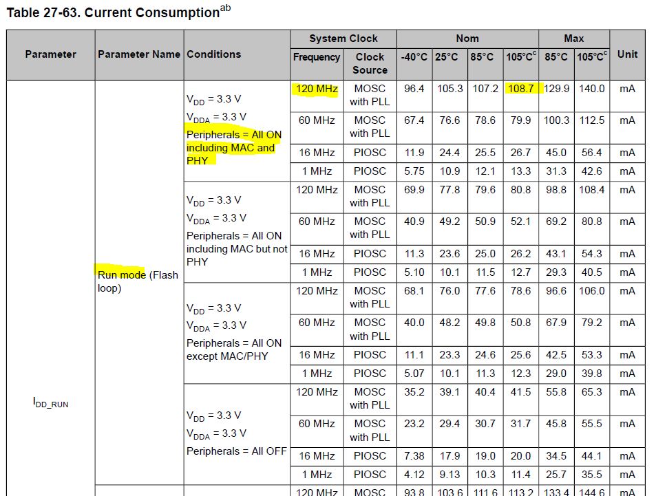

    Can I directly connect RS485 IC which has operating voltage of 5V to the UART of the controller?
    Also Max current consumption of the IC is specified as 64mA?
    Does it change with crystal  Frequency?
    Anushka

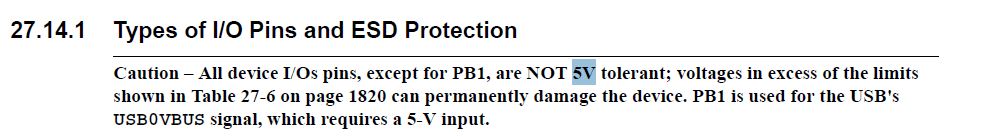

    The MCU you are migrating to is TM4C1294KCPDT which is not 5V tolerant. You must obey the IO limitation specified in the TM4C1294KCPDT datasheet and use level shifter to interface to external components that are not 3.3V.  The TM4C123 family is 5V tolerant. However, it doesn't not meet your system requirements as it does not have Ethernet and other peripherals which are available in the TM4C129.
    Thank you, cb1 for providing much of the answers.
    Anushka, can you tell me from which operating condition under which the MCU will consume 64mA in the datasheet? The current consumption shown in the datasheet depends on which operating conditions the MCU is operating in such as frequency, temperature and operating mode (run, sleep, deep sleep). If you are running at 120MHz with all the peripherals turned ON at 105 degree with nominal process it could be up to 108mA.

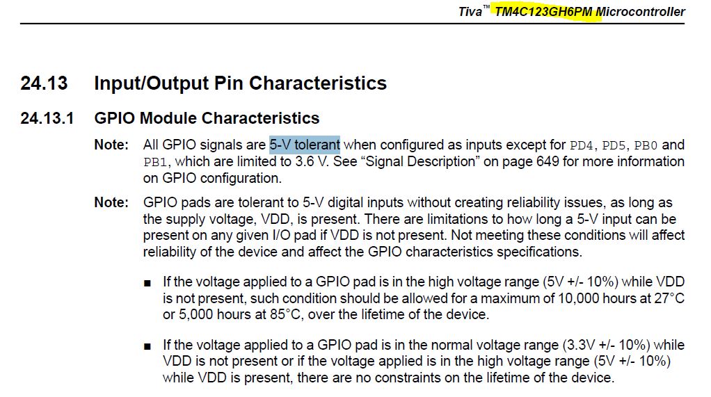

    We (must) ask: is it proper for us to 'highlight' a (rather clear) CONFLICT w/in the presented 'datasheet extract!'
    Conflict follows:
    27.14.1   All device I/O pins, except for PB1, are NOT 5V tolerant.
    And this is (very) shortly followed by: "All GPIO signals are 5-V tolerant  when configured as inputs!"    (this from your 1st Note)
    And then - reinforcing the above - "GPIO pads are tolerant to 5-V digital inputs  without creating reliability issues"   (this from your 2nd Note)
    Might you review & 'inform/advise?'     (we've added 2nd/3rd 'line' - to prevent the wildly flapping, 'Conflict Pennant' - from becoming 'Lost at Sea.')
  • Hi cb1,
      Sorry for the confusion. The first note was taken from the TM4C129 datasheet while the second note was from the TM4C123 datasheet. I recapture the notes in the below two screenshots. Hope it will clarify.
