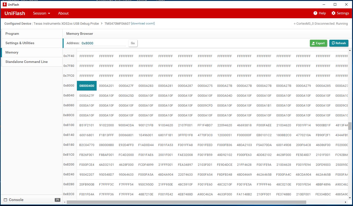

  • Your application code starts with vectors at 0x8000, but the link command file for the bootloader defines flash memory as starting at 0x1600 of length 0x9EEFF, (0x1600 to A04FF). This means your boot loader may spill into where you put the application. Did you mean to define FLASH0 for the bootloader as:
        FLASH0  (RX)     : origin=0x00001600 length=0x00006A00
    A common mistake made on bootloaders for the Cortex M3 is to forget that the reset vector (which in your case is at 0x8004) needs to be an odd address (address+1) because the M3 only executes the Thumb2 instruction set.
  • Hello Bob,
    Thanks for the reply...
    How to change the reset vector address at 0x8004 to an odd address. Does this mean that i have to change the NVIC address of the application program which is currently configured at 0xE000E000U in sys_startup.c file
    #define NVIC  0xE000E000U
    If so what value should i define to NVIC.
    Thanks and Regards,
    Anand Kumar D
  • What I mean is that the value stored at location 0x00008004 should be an odd number. If you used the standard sys_intvecs.asm with the "_c_int00" symbol to create the .intvecs section of your application code, everything should work. Just use either UniFlash or CCS to read the values that were programmed into locaitons 0x00008000 (stack pointer) and 0x00008004 (start address plus 1).

    The value at 0x8004 is 0x01
     TMS470_RTC_Test.rar
    I have attached my application project. Please have a look at the same and guide me where i am wrong.
    Thanks and Regards,
    Anand Kumar D
  • Hello Bob,
    I observed that the code is working fine at start address 0x8000 with and without boot loader when the all the interrupts are disabled. But when the interrupts are enabled it’s not working.
    How and where should I define the Vector table offset value.
    Thanks and Regards,
    Anand Kumar D
  • Yes, before enabling interrupts in the application write 0x00008000 to location 0xE000ED08.
  • Hello Bob,
    Thanks for your support. We finally got everything working. We followed the following.
    Jump from boot loader to app address:
    uint32 JumpAddress = *(uint32*)(APP_START_ADDRESS+4);
    ((void (*)(void))JumpAddress)();
    Jump from app to Boot loader:
    rtiStopCounter(rtiCOUNTER_BLOCK0);
    rtiStopCounter(rtiCOUNTER_BLOCK1);
    rtiDisableNotification(rtiCOMPARE3);
     _disable_IRQ();
     *(uint32*)0xE000ED08 = 0x00000000;
    systemREG->SYSECR = 0x8000;
    Thanks and Regards,
    Anand Kumar D
