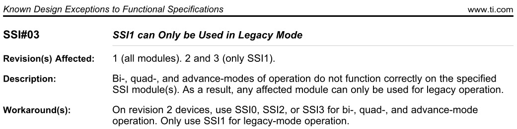

  • Okay,
    I had some trouble importing your project because of compiler version 18.12 which I had to install.
    Then the complier not showing up in Window->Preferences->CCS->Build->Compilers
    So I made a new project and copy and past your code.
    I still testing it on my custom board, but I see
    - SPIFlashReadID() correct
    - SPIFlashRead() correct
    - SPIFlashReadNonBlocking(uDMA=false) correct

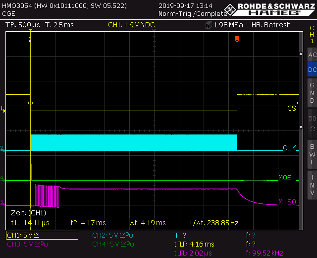

    - SPIFlashReadNonBlocking(uDMA=true) not working
    Here you can see SPIFlashReadID() from my scope:
    SPIFlashRead() and SPIFlashReadNonBlocking(uDMA=false) looks the same:
    and here SPIFlashReadNonBlocking(uDMA=true):
    I try to save pState->ui16State in the interrupt, so I can see what happen.
    This is what I see:
    STATE_CMD -> STATE_ADDR1 -> STATE_ADDR2 -> STATE_ADDR3 -> STATE_READ_DATA_SETUP -> STATE_READ_DATA_DMA -> STATE_READ_DATA_DMA -> STATE_READ_DATA_END -> STATE_READ_DATA_END
    Any idea?

  • Okay,
    I changed
        uDMAChannelAssign(UDMA_CH10_SSI1RX);
        uDMAChannelAssign(UDMA_CH11_SSI1TX);
    to
        uDMAChannelAssign(UDMA_CH24_SSI1RX);
        uDMAChannelAssign(UDMA_CH25_SSI1TX);
    and
        SPIFlashReadNonBlocking(&sState, SSI1_BASE, 0, pui8data2, 256, true,
                                UDMA_CH11_SSI1TX, UDMA_CH10_SSI1RX);
    to
                                UDMA_CH25_SSI1TX, UDMA_CH24_SSI1RX);
    and now it works, but why?

    What induced you to make those changes?    (from Chans: 11 & 10 to 25 & 24)     My group has never used this MCU - yet your 'thought pattern' has generated high interest.
    May we offer (almost) 'Congratulations.'    How sure are you that indeed, 'It works!?'      We are 'hopeful for you' - yet w/out great experience w/this specific µDMA - does your test protocol prove 'sufficient in design' & 'extensive enough' - to catch even (minor) errors?
    (it still would be of immense value to see (via test - contrasting DMA On then Off)  'if & by how much' - this effort paid off...)     Note ... while the µDMA is looping/running - might (some) 'reductions in performance' occur elsewhere w/in the MCU - thus reducing the 'overall gain?'

    But I think I found the mistake. I use SPI legacy mode on SSI1 and the spi_flash.c functions use advance mode:
    void
    SPIFlashInit(uint32_t ui32Base, uint32_t ui32Clock, uint32_t ui32BitRate)
        // Configure the SPI module.
        MAP_SSIConfigSetExpClk(ui32Base, ui32Clock, SSI_FRF_MOTO_MODE_0,
                               SSI_MODE_MASTER, ui32BitRate, 8);
        // Enable the advanced mode of operation, defaulting to read/write mode.
        MAP_SSIAdvModeSet(ui32Base, SSI_ADV_MODE_READ_WRITE);
        // Enable the frame hold feature.
        MAP_SSIAdvFrameHoldEnable(ui32Base);
        // Enable the SPI module.
        MAP_SSIEnable(ui32Base);
    BUT in errata - spmz850g.pdf under SSI#03 is this:

  • Sorry, I have not been able to find any more details on the erratum SSI#03 to determine if there is any relationship to using DMA channels 10 and 11 instead of 24 and 25. My hardware uses SSI3, so I never saw that issue. But you are correct that the erratum precludes using SSI1 with the SPIFlash routines.
