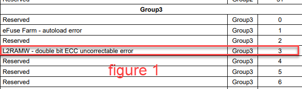

I have used IC RM57L843BZWTT, and when debugging, self-diagnosis failed often.The error information that the software engineer found was L2RAMW-double bit ECC uncorrectable error below group3 and number3 as figure1.
However, after power-up stabilization give a reset signal at nPORRST pin it's always pass. I suspected that the power-on reset sequence goes wrong, carefully tested the power-on reset waveform did not find any problem.
Please help me analyze why.

    1. The ESM3:3 error is not caused by ECC double diagnostic error. ESM3:3 is caused by the:
        a. Write SECDED malfunction error (WEME bit of RAMERRSTATUS register)
        b: Redundant address decode error (ADE bit of RAMERRSTATUS register)
        c: Read SECDED malfunction error (REME bit of RAMERRSTATUS register)
    2. The ESM2:7 error is caused by ECC double diagnostic error
    Please check the RAMERRSTATUS register. The bit[22] and bit[20] should be set by the ECC double diagnostic error.

    2, and check the register RAMERRSTATUS value is 0X80, when ESM3 value is 0X08

    You are correct. ESM3.3 is caused by ECC double error. RMWDE=1 indicates that the error happens during read access of the read modify write operation. But it is caused by the diagnostic test or selftest.
    If you don't call the SDL API to do RAM ECC selftest, is there an error on ESM3.3?

    What is the value of RAMERRSTATUS register? Is the ESM3.3 set before running the memory init? Can you try the latest version of SDL (rev 2.4.0)?
  • See this thread:
    The issue also applies to RM57 as ECC checking is enabled for all Flash/RAM accesses on RM57 and LC43.
