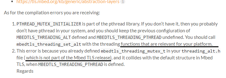

  • Hi Charles,
    I contact with mbed tls support team, and tried to implement as per their suggetions. The ssl context setup function 'mbedtls_ssl_setup' calls malloc function from 'ti/ccsv6/tools/compiler/arm_5.1.6/lib/src/memory.c' file.

    threading_mutex_free_pthread functions are not really third party. It is actually under "third_party/mbedtls/ti/port/threading_alt.c" file; where port is belongs to core I guess.
    I have msp432e401y eval kit and i am testing publish_subscribe example on it. Here they are using RTOS with ndk stack along with mbedtls. But in my case I am using non RTOS with lwip along with mbedtls.
    As I move further with debugging, threading_mutex_free_pthread function calls pthread_mutex_lock function. It further moves to acquireMutex function in 'C:\ti\simplelink_msp432e4_sdk_3_10_00_11\source\ti\posix\tirtos\pthread_mutex.c' file. So instead of msp432 tirtos posix, how can I use tm4c1294kcpdt nortos lwip for this?

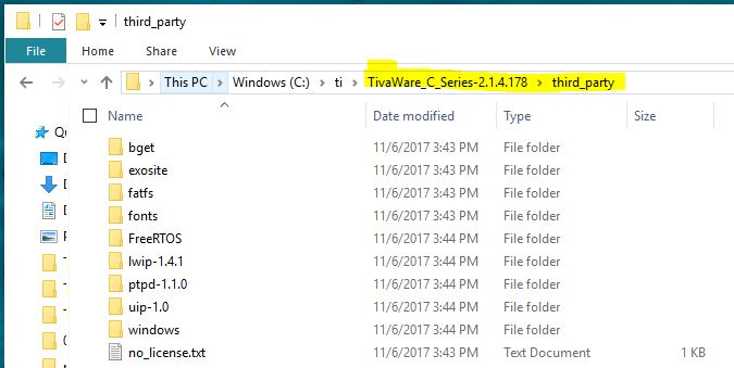

      Below are all the third party code from the latest TivaWare 2.1.4.178 release. There is no mbedtls. I'm not sure where you get it from. Please understand I really can't support something that we don't have in TivaWare release.
    It seems like the mbed TLS is from ARM. If this is the case, would you please contact their support for assistance? https://tls.mbed.org/tech-updates/blog/announcing-lts-branch-mbedtls-2.16

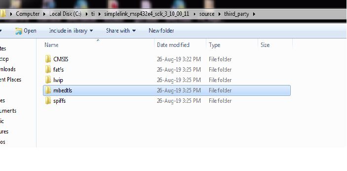

    TivaWare_C_Series_x doesn't has mbedtls. I am refering it from simplelink_msp432_sdk_x. See below attached image:
    I have already contact mbedtls support team and as per their suggestions I tried to implement the steps and many of bugs get resolved. But at this point I got stuck in this errors that threading_mutex_free_pthread() functions are unresolved.
