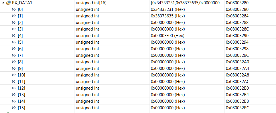

I am trying to implement DMA based receive of a block of CAN data, I have configured DCAN 1 for CAN transfer(which is working fine for functionalities other than DMA) and using DCAN 1 IF3 for receiving data by DMA.

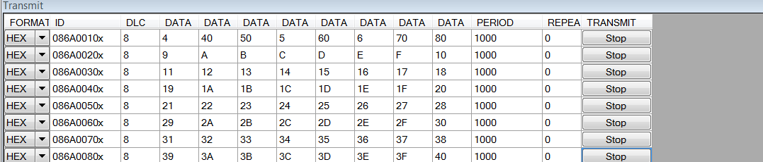

I have configured 8 mailboxes for the same and transmitting 8 can frames by Microchip CAN BUS analyser transmit features.
Below is my code for DMA with CAN-
uint32 RX_DATA1[D_SIZE]= {0};    /* receive  buffer in sys ram */
uint32 DMA_Comp_Flag;

With the above code I am having 2 problems-
1.If i give a free run or a step over command, the code gets stuck in phantom interrupt but I am  able to run the code with step into commands.
2. Even when the code runs, I am getting data from only one of the frame (8 bytes) and that too in some different order which gives me a signal that there's something wrong with endianess however I have not changed any addresses manually and it is all generated by halcogen and working fine for features other than DMA.
I have attached the image of transmitted and received data.
can you please help me identify the issue and also suggest me the possible solution for the same?
