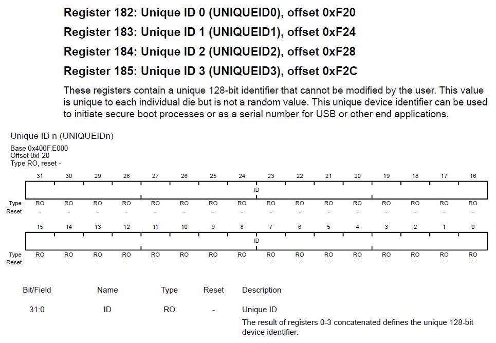

Hi Nikhil,
Please refer to the Unique ID registers below. This is a 128-bit unique ID.
Please also refer to this post.
