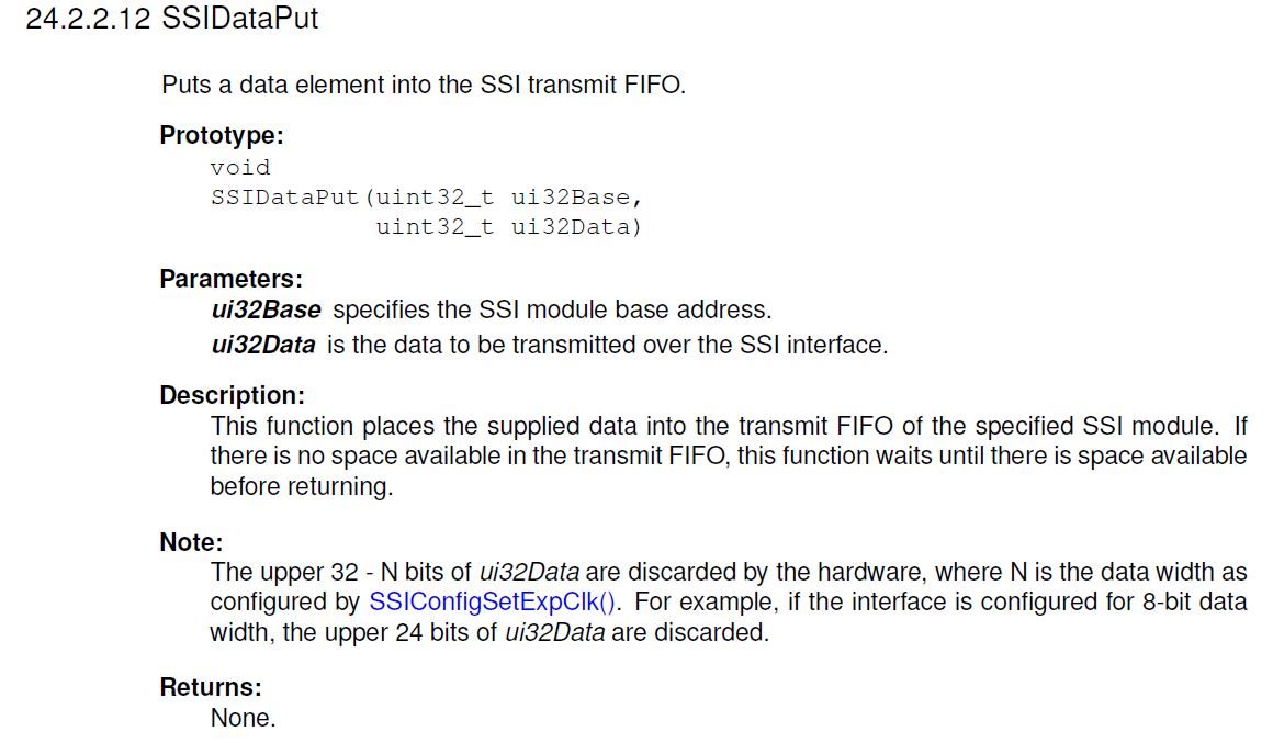

I try to configurate SSI (SPI) but without success. I have problem with clock signal. I try with different SSI base (SSI0_BASE and SSI2_BASE) and I got same result, clock is 0 all the time. When I put oscilloscope on clock, result is same, always 0. Here is code :

void Init_SSI_2(void){
    SysCtlPeripheralEnable(SYSCTL_PERIPH_SSI2);
    SysCtlPeripheralEnable(SYSCTL_PERIPH_GPIOB);
    SysCtlPeripheralEnable(SYSCTL_PERIPH_GPIOF);
    GPIOPinTypeGPIOOutput(GPIO_PORTF_BASE, GPIO_PIN_1 | GPIO_PIN_2 | GPIO_PIN_3);
    GPIOPinConfigure(GPIO_PB4_SSI2CLK);
    GPIOPinConfigure(GPIO_PB5_SSI2FSS);
    GPIOPinConfigure(GPIO_PB6_SSI2RX);
    GPIOPinConfigure(GPIO_PB7_SSI2TX);
    GPIOPinTypeSSI(GPIO_PORTB_BASE, GPIO_PIN_4 | GPIO_PIN_5 | GPIO_PIN_6 | GPIO_PIN_7);
    SSIDisable(SSI2_BASE);
    SSIConfigSetExpClk(SSI2_BASE, SysCtlClockGet(), SSI_FRF_MOTO_MODE_0, SSI_MODE_MASTER, 1000000, 8);
    SSIEnable(SSI2_BASE);
void main(void){
    SysCtlClockSet(SYSCTL_USE_PLL | SYSCTL_OSC_MAIN | SYSCTL_XTAL_16MHZ | SYSCTL_SYSDIV_4); // clock set 50MHz
    Init_SSI_2();
    while(1){
if(GPIOPinRead(GPIO_PORTB_BASE, GPIO_PIN_4) == GPIO_PIN_4){
            GPIOPinWrite(GPIO_PORTF_BASE, GPIO_PIN_1, GPIO_PIN_1);
             SysCtlDelay(50000000);
             GPIOPinWrite(GPIO_PORTF_BASE, GPIO_PIN_1, ~GPIO_PIN_1);
  • Hi Milan,
      You only initialize the SSI module. In order to start a SPI transmission you must write data to the SPI FIFO. Once the FIFO is written the transmission will start. I don't see you calling SSIDataPut() to start the transmission. Once you call SSIDataPut() you should see SPICLK. Please also refer to the TivaWare SSI example under <TivaWare_Installation>/examples/peripherals/ssi.
