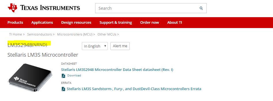

  • Hi Tao,
      Please note that this is a NRND (Not Recommended for New Design) part. With that said, we don't have timing diagram showing the timing from the ADC input is sampled until the CPU reads the data. However, I think you can find out this timing with some experiment if there is a pressing need to find out. You just need to set a GPIO pin high after you read the FIFO data. You know when you are providing the ADC inputs. Therefore, you can just measure the time when the ADC input is provided until the GPIO pin is set. This will tell you the total time from ADC->FIFO-CPU.

  • Hello Charles,
    Thank you for reply.
    My customer has been using LM3S2948 on their application since 2015.
    Recently they are facing conversion data issue on internal ADC.
    As you know, there are many issue on this device.
    I informed to them your suggestion(GPIO) .
    To avoid ADC issue, I will propose software measures as other suggestion.
    (Sampling several ADC data and cancel incorrect data.)
    And I will suggest to check ADC errata.
    I will discuss with them in this week , because I'm not sure know how far they understand the device issue.
