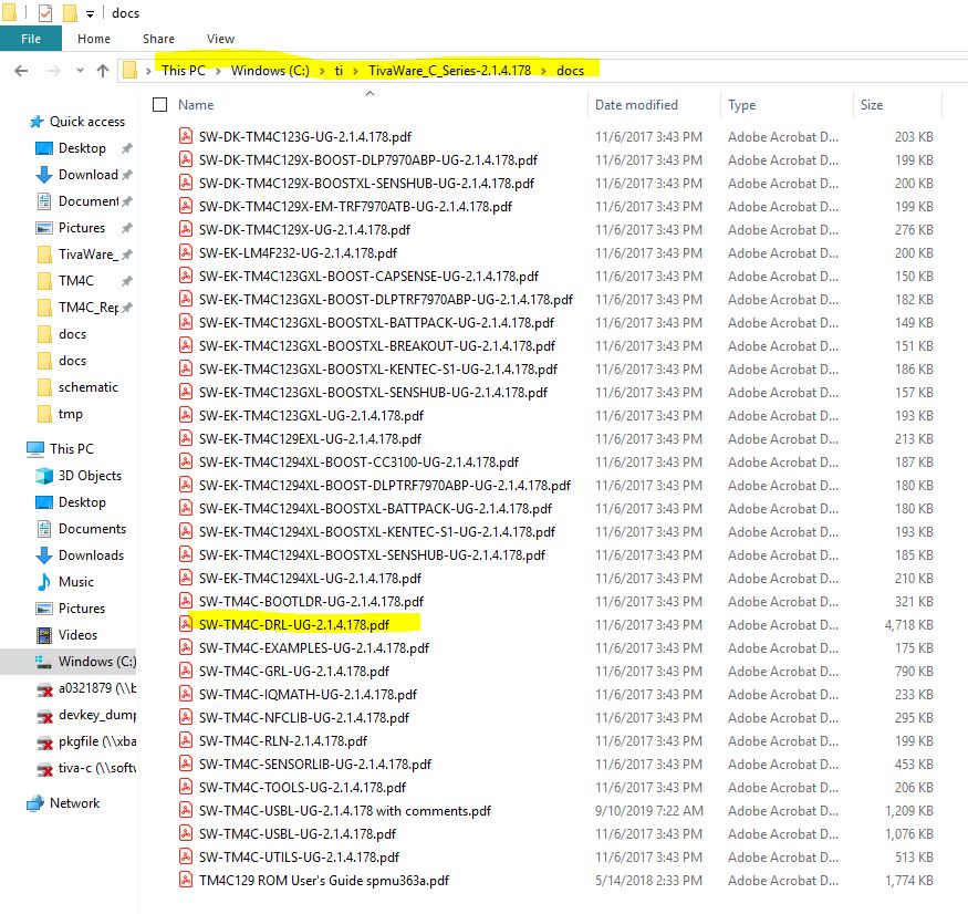

Are these are right registers and the way of initailizing?
Don't understand  any sugguestion..its very hard to understand because TM4c129ENCPDT microcontroller have no  Peripheral Driver Library user guide for TM4c129ENCPDT.
  • Hi Sobia,
      If you have not done so, please download the TivaWare library from http://www.ti.com/tool/SW-TM4C. The TivaWare library contains all the drivers, examples and documentation.
     Once you download the TivaWare library, you can find the peripheral driver library user's guide in below place.
    You can find the drivers source code under <TivaWare_Installation>/driverlib.
    For UART examples, you can find under <TivaWare_Installation>/examples/peripherals/uart
    Please note that we are against developing your application without using the TivaWare. Your presented code using DRM (Direct Memory Manipulation) will be prone to errors and hard to debug.
