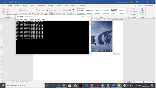

TM4C1294NCPDT: Problem in receiving can messages with particular CAN ID
Part Number: TM4C1294NCPDT
     I am transmitting multiple CAN messages with different ID and try to receive only particular CAN message with a particular CAN ID. Can able to transmit multiple messages with different ID. but while receiving I cant able to receive the desired CAN message with a particular CAN ID. Plz help
Transmitter Code:

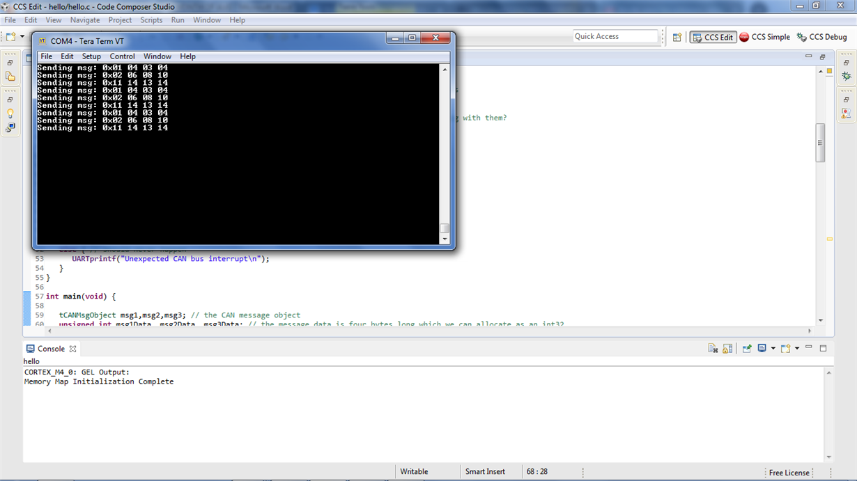

   unsigned int t = 0; // loop counter
   float freq = 0.3; // frequency scaler
   while(1)
         	        msg1DataPtr[0] = 0x01;
	   		msg1DataPtr[1] = 0x04;
	   		msg1DataPtr[2] = 0x03;
	   		msg1DataPtr[3] = 0x04;
	   					msg2DataPtr[0] = 0x02;
	   			   		msg2DataPtr[1] = 0x06;
	   			   		msg2DataPtr[2] = 0x08;
	   			   		msg2DataPtr[3] = 0x10;
	   			   				msg3DataPtr[0] = 0x11;
	   			   		   		msg3DataPtr[1] = 0x14;
	   			   		   		msg3DataPtr[2] = 0x13;
	   			   		   		msg3DataPtr[3] = 0x14;
if (UARTCharsAvail(UART0_BASE))
	if(UARTCharGetNonBlocking (UART0_BASE)=='a')
	   		UARTprintf("Sending msg: 0x%02X %02X %02X %02X\n", msg1DataPtr[0], msg1DataPtr[1], msg1DataPtr[2], msg1DataPtr[3]); // write colour to UART for debugging
	   		UARTprintf("Sending msg: 0x%02X %02X %02X %02X\n", msg2DataPtr[0], msg2DataPtr[1], msg2DataPtr[2], msg2DataPtr[3]); // write colour to UART for debugging
	   		UARTprintf("Sending msg: 0x%02X %02X %02X %02X\n", msg3DataPtr[0], msg3DataPtr[1], msg3DataPtr[2], msg3DataPtr[3]); // write colour to UART for debugging
IntMasterDisable();
CANMessageSet(CAN1_BASE, 1, &msg1, MSG_OBJ_TYPE_TX); // send as msg object 1
CANMessageSet(CAN1_BASE, 2, &msg2, MSG_OBJ_TYPE_TX); // send as msg object 1
CANMessageSet(CAN1_BASE, 3, &msg3, MSG_OBJ_TYPE_TX); // send as msg object 1
      delay(100); // wait 100ms
      IntMasterEnable();
      if(errFlag) { // check for errors
         UARTprintf("CAN Bus Error\n");
      t++; // overflow is fine

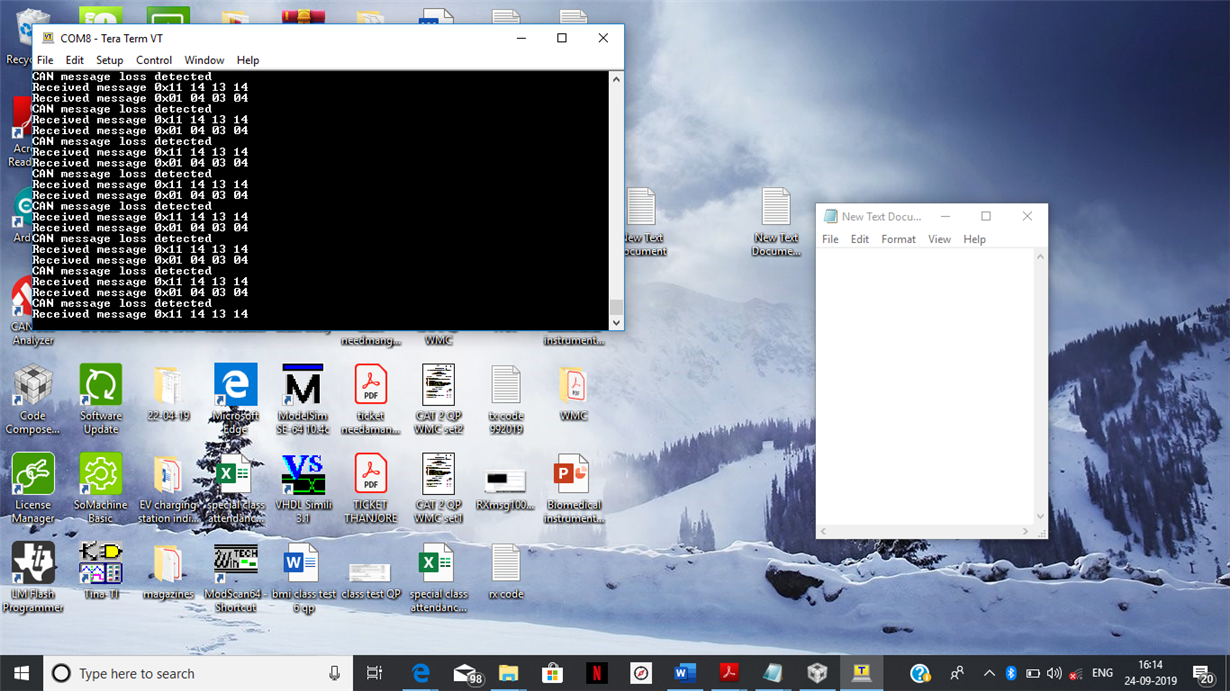

   //CANMessageSet(CAN1_BASE, 1, &msg1, MSG_OBJ_TYPE_RX);
  CANMessageSet(CAN1_BASE, 2, &msg2, MSG_OBJ_TYPE_RX);
  //CANMessageSet(CAN1_BASE, 3, &msg3, MSG_OBJ_TYPE_RX);
 //  unsigned int colour[3];
//   float intensity;
   unsigned int rcv1msg[4];
   unsigned int rcv2msg[4];
   unsigned int rcv3msg[4];
   while(1) {
	  //IntMasterEnable();
      if(rxFlag) { // rx interrupt has occured
         msg2.pui8MsgData = msg2Data; // set pointer to rx buffer
         CANMessageGet(CAN1_BASE, 2, &msg2, 0); // read CAN message object 1 from CAN peripheral
         rxFlag = 0; // clear rx flag
         if(msg2.ui32Flags & MSG_OBJ_DATA_LOST)
          { // check msg flags for any lost messages
              UARTprintf("CAN message loss detected\n");
              msg2.ui32Flags &= ~MSG_OBJ_DATA_LOST;
           // Set the new state of the message object.
     	                rcv2msg[0] = msg2Data[0] ;
     			rcv2msg[1] = msg2Data[1] ;
     			rcv2msg[2] = msg2Data[2] ;
     			rcv2msg[3] = msg2Data[3] ;
     			// write to UART for debugging
     			UARTprintf("Received message 0x%02X %02X %02X %02X\n", rcv2msg[0], rcv2msg[1],rcv2msg[2],rcv2msg[3]);

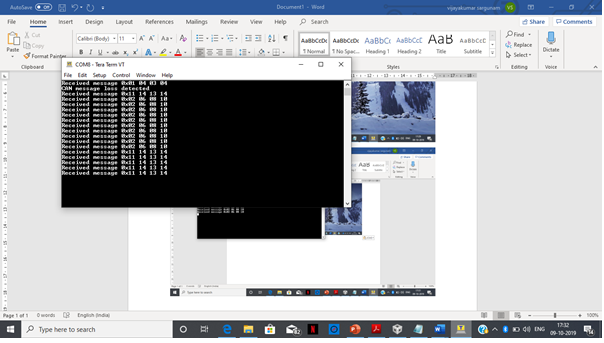

      I'm not clear with your question. Can you please elaborate which CAN ID are you expecting to receive and what is the expected message data associated with it?
      Please also describe your hardware setup? Are you setting up two different MCU controllers as two nodes on the CAN network with one as TX and another as RX?
  • Hi Tsai
    I am using 2xTIVAC (TM4C1294NCPDT) controllers for CAN communication (one as TX and another as RX) as well as I am using 2xMCP2551 as CAN transceiver(s). I am trying to receive the messages associated with CAN ID = 2 (ui32MsgID = 2). My output data should be like Received message 0x02 0x06 0x08 0x10 but I am receiving data messages associated with CAN ID(s) 1 and 3 along with data loss.
      I suspect something wrong with your interrupt handler. You wrote below:
    // CAN interrupt handler
    void CANIntHandler(void) {
       unsigned long status = CANIntStatus(CAN1_BASE, CAN_INT_STS_CAUSE); // read interrupt status
       if(status == CAN_INT_INTID_STATUS) { // controller status interrupt
          status = CANStatusGet(CAN1_BASE, CAN_STS_CONTROL);
          errFlag = 1;
       } else if(status == 1) { // msg object 1
          CANIntClear(CAN1_BASE, 1); // clear interrupt
          rxFlag = 1; // set rx flag
          errFlag = 0; // clear any error flags
      You are trying to get the status of the CAN_STS_CONTROL and use the return value to determine which CAN message object receives the data. The CAN_STS_CONTROL doesn't provide information about which message object has the new data. You should change from CAN_STS_CONTROL  to CAN_STS_NEWDAT as to query which message object contains the data. It is likely this is the problem.
      You should start with something simple. Instead of transmitting multiple messages you should start with only one message with the CAN ID equal to 2 since this is the one that has trouble to receive.
  • Hi charles,
                As you suggested I tried to transmit only one CAN message with ID 2 and tried to receive the same. I can able to receive the message with ID 2
    after that I tried to transmit the message with ID 3 only, According to the receiver code it should not be received but I can able to see the message with ID 3 also in the terminal.
    As you suggested I changed the interrupt routine of receiver code from CAN_STS_CONTROL  to CAN_STS_NEWDAT
    But in the terminal I cant able to see any message it was blank but if I changed the code from CAN_STS_NEWDAT to CAN_STS_CONTROL I can able to see the above output help me in this regard
      You have written the below code. I will suggest you clean up your code first for readability. Why are you setting three message objects?
