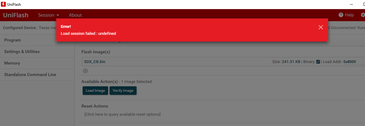

I have tried several versions of uniflash on my windows 10 laptop the last few months and am unable to save my session.  It goes through the motions of saving, but when I look at my folder where I supposedly saved the file, it is not there.  Any thoughts.
If I load a working a file from another computer where this functions correctly, I get the following message.
  • slugdoug
    That is a new one.  In the screen capture I see the flash image as SDX_CB.bin.  Was that something that you had before loading the session?  Just trying to figure out if it was able to read part of the information from the session file.  With the cloud version I have loaded sessions on different machines but I haven't tried sharing one between desktop versions before.  I suspect that their may be some path info causing issues.  Such as the path to the flash image.
