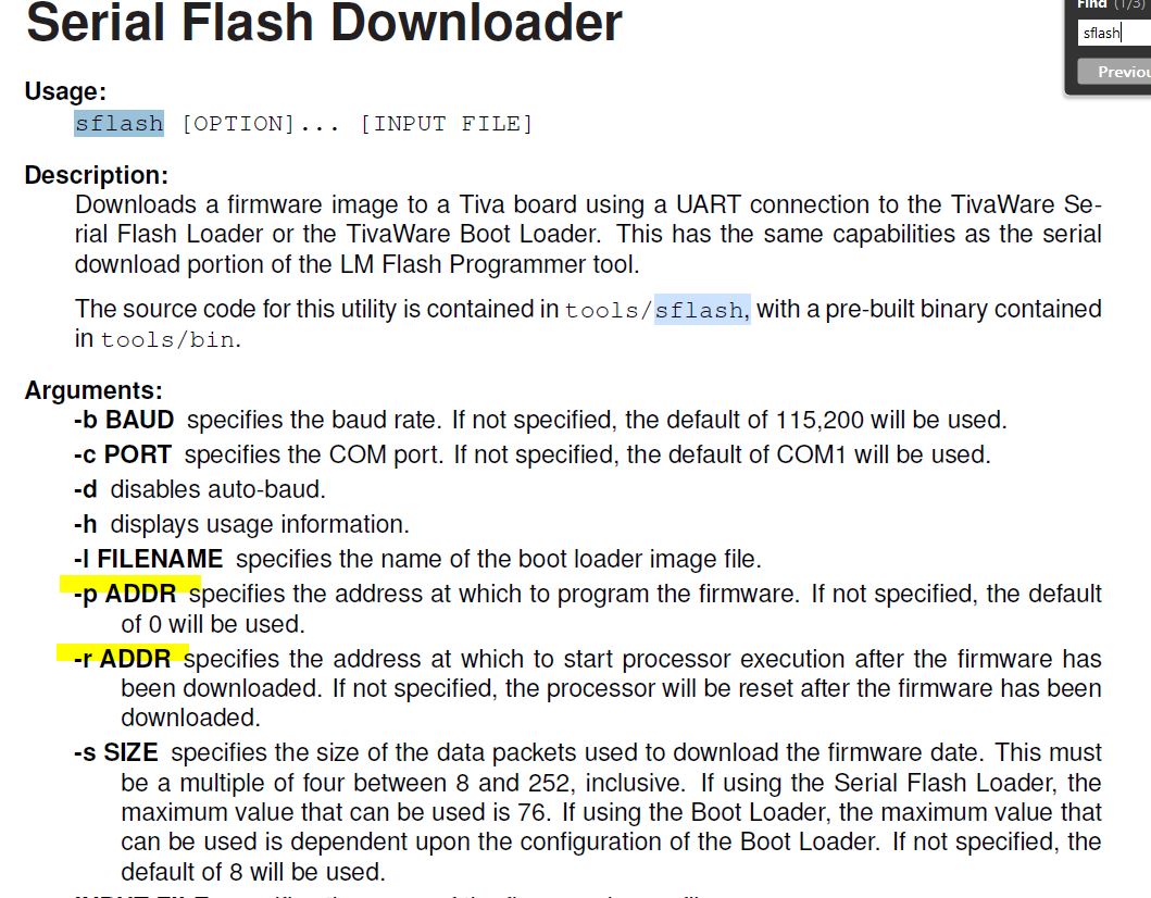

Following the documentation and code from TI I was able to implement a boot loader on my custom board with a TM4C1290NCPDT loaded at 0x0 in FLASH and my application at 0x4000. I am able to reload my application with this boot loader successfully using the sflash.exe code that I compiled from the Tivaware tools directory. It all works great, thanks!
However, I am unable to re-start the microcontroller after loading it with a boot loader, and I seem to need a full power cycle to get it to go again (at which point it works fine.)
I am sending sflash the run command with the address 0x4000 (the address of the start of my application in flash.) is that the right address I should be passing in? I thought so but now I wonder if it should instead be the resetISR vector? I am confused. I have also tried 0x0 (which is where the boot loader is in flash) and that doesn’t work either.
Power cycling my board is not a big deal but it is a bit painful as there are other parts like FPGAs that then take time to reconfigure.
Peter
sflash command:
./sflash ../cm_mcu.bin -r 0x4000 -p 0x4000 -c /dev/ttyUSB2 -b 115200 -d -s 76
[Though I think it’s not needed to answer this problem, I’m using the latest version of Tivaware on a Linux box based on RHEL7 with a gcc based Makefile compilation path.]

  • Hi Peter,
      Did you set the -r ADDR to 0x4000? You should set it to 0x4000 so the processor will jump to it after the firmware is downloaded.
    Hi Charles
    Yes I use the following command. I tried setting it to both 0x4000 and 0x0 and neither works. Strangely
    Strangely my version of the command has the default that no run command will be sent, not that the processor will be reset like the one you list above. I am using Tivaware 2.1.4.178.
    I suppose I’ll just add a SysCtlReset() call like you propose. Thanks for your time.
