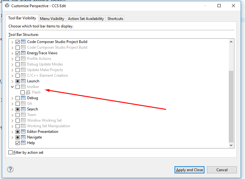

I cant find flash icon in ccs.. Below are some images which can help I think.

Hello Milan,
It should be enabled by default. I'm not sure why the option to enable it is greyed out for you. Try resetting the perspective. If that does not help, try using a new workspace.
https://software-dl.ti.com/ccs/esd/documents/users_guide/ccs_troubleshooting.html#general-ide
