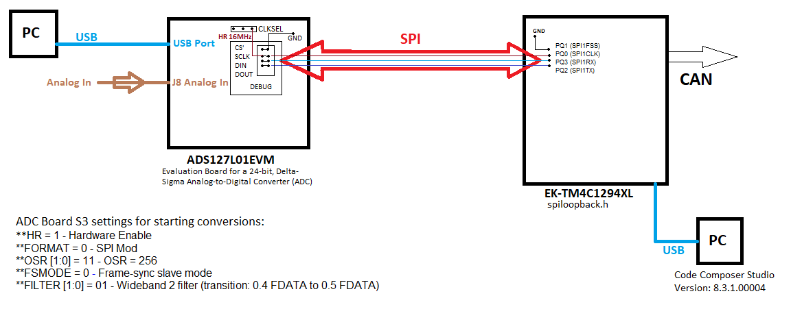

I'm using EK-TM4C1294XL via Code Composer Studio Version: 8.3.1.00004 and spiloopback. Also I have ADS127L01EVM.
With these parts, I'm making ADC and I want to read with EK-TM4C1294XL (SPI) than I want to send It to the CAN line.
spiloopback.h is working on the EK-TM4C1294XL but I can not read any data from ADS127L01EVM.
I build like the jumper wire connections are needed for the external SPI loopback example. | PD3->PQ0, PD2->PQ1, PD0->PQ2, PD1->PQ3 and the spiloopback works.
Now,
TM4C PQ1 to GND
ADS SCLK ->TM4C PQ0 - SLAVE
ADS DIN -> TM4C PQ2 - SLAVE
ADS DOUT -> TM4C PQ3 - SLAVE

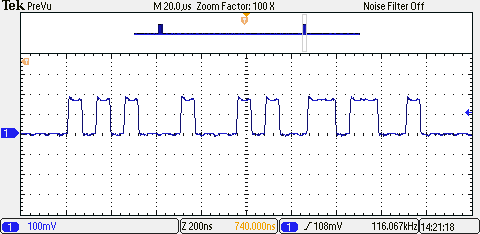

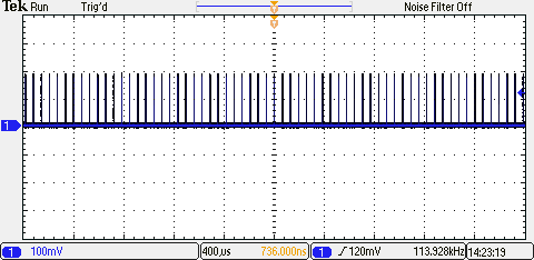

ADS input frequency is 16MHz and output (DOUT) frequency is about 130kHz. It works and i add my oscilloscope-screenshots
so I made some additions to the program.
