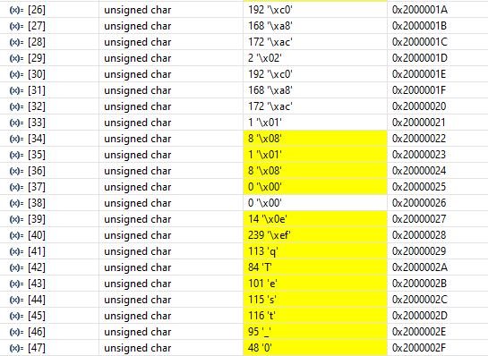

  • Hi Charles,
    Yes i went throught the LwIP UDP example.
    Actually i started couple of weeks ago with uIP therefore i am using this example.
    Second i don't see any DMA in the LwIP where i should be able to Receive packet and transmit packet and no buffers. Correct me if i am wrong. In LwIP what it is doing is receving the packets and sending it back to specified port and a new IP.
    Third, what i want to do is that i have send the packet and the packet is received and copied to the buffer. Now the packet is in the buffer,
    I want to do know is to extend the payload in the buffer and change the length before transmitting it back from the MC to PC.
    Packet received and stored in the uIP_buf and transmitted from PC to MC.
    For example a photo attached: UDP packet
    1. Source port
    2. Destination port.
    3. Length
    4. Check sum
    5. Data
    this can be seen in my picture.
    Now this payload (buffer data) is in microcontroller software and i want to only change the payload of the data packet and specify the port number on which i want to send. And then transmit it back to the PC.
    Before Transmitting the packet the buffer should have only the data and the length change e.g from (Test_0) to (Test_4321_echo)  plus the port number.
    Can you help me how should i approach to this problem. I tried some example but don't works.
