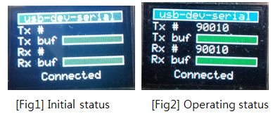

Q1> Are the green bars unchanged in [Fig1] and [Fig2] ?
       The green bar is always full.
Regards.
Jame,Shin
  • Hi Jame,
      I think the green bar is always full is correct. When it is fully green it means it is empty. If there is some transfer, a portion of the green bar will be filled with red.
      When it is first initialized in the main(), the DrawBufferMeter() is called. If you look at the source code of DrawBufferMeter it has the below code that says the meter is filled with green to indicate empty.
    // Fill the meter with green to indicate empty
    GrContextForegroundSet(psContext, ClrGreen);
    GrRectFill(psContext, &sRect);
    // Put a white box around the meter.
    GrContextForegroundSet(psContext, ClrWhite);
    GrRectDraw(psContext, &sRect);
    Please also look at the UpdateBufferMeter() API where the portion or all of the green bar is filled with red depending on the transfer status.

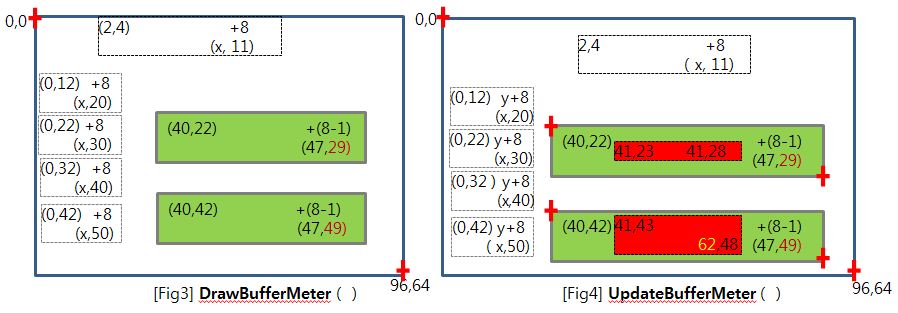

  • Hello Charles,
    Thank you for your reply.
    I analyzed it with what you answered.
    The example source code seems to be a problem.
    When the ui32Fullness value becomes a constant, a red bar is drawn unconditionally.
    And the green bar is overwritten again at a high speed, which is not visible with eyes.
    How can I display data in a FIFO with a color bar?
    // Called by the main function.
    DrawBufferMeter(&g_sContext, 40, 22);
    DrawBufferMeter(&g_sContext, 40, 42);
    // Has there been any (transmit or receive) traffic since we last checked?
        1   byte sent to UART Tx to USB Rx buffer       (1 * 100) / 256 = 0.390625 ,  result 0
       100 byte sent to UART Tx to USB Rx buffer       (100*100)/ 256 = 39.0625 ,   result 39
    ui32Fullness = ((USBBufferDataAvailable(&g_sRxBuffer) * 100) / UART_BUFFER_SIZE);
    UpdateBufferMeter(&g_sContext, ui32Fullness, 40, 22);
    ui32Fullness = ((USBBufferDataAvailable(&g_sTxBuffer) * 100) / UART_BUFFER_SIZE);
    UpdateBufferMeter(&g_sContext, ui32Fullness, 40, 42);
    // Fill the full section with red (if there is anything to draw)
    UpdateBufferMeter(tContext *psContext, uint32_t ui32FullPercent, int32_t i32X, int32_t i32Y)
    // Determine where the break point between full (red) and empty (green) sections occurs.
       i32XBreak = (i32X + 1) + (ui32FullPercent * (BUFFER_METER_WIDTH - 2)) / 100;
                       case1>  // ( 40+1) + ( 0 * 54) / 100 = 41 + 0     = 41
                        case2>  // (40+1) + (39 * 54)/100 =   41 + 21.06 = 62
    if(ui32FullPercent)
           GrContextForegroundSet(psContext, ClrRed);
       // Fill the empty section with green
       sRect.i16XMin = i32XBreak;
       sRect.i16XMax = i32X + BUFFER_METER_WIDTH - 2;
       if(sRect.i16XMax > sRect.i16XMin)
           GrContextForegroundSet(psContext, ClrGreen););
       // Revert to white for text drawing which may occur later.
    regards,
    Jame,Shin

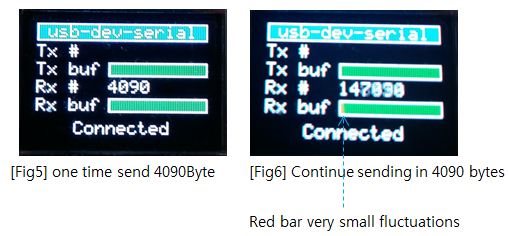

  • Hi Jame,
      The color bar just tries to reflect how many data are available in either the TX or RX USBbuffer. I don't really see a problem with it. I see the RED color changing from left to right. Note that the UpdatBufferMeter is only updated when there is any transmit or receive traffic from the perspective of the UART. You can try to transfer a large amount of data (i.e. a text file) from the USB to the UART. You will see the Tx bar changing rapidly.
  • Hello Charles,
    In [Fig. 5], the red bar is hard to see when a lot of data is sent once.
    [Fig. 6] shows a very small red bar variation when sending a lot of data.
    I'm a bit hard to check.
    Does that mean I can see the tx bar you told me changing rapidly ?
    There is no see obvious change.

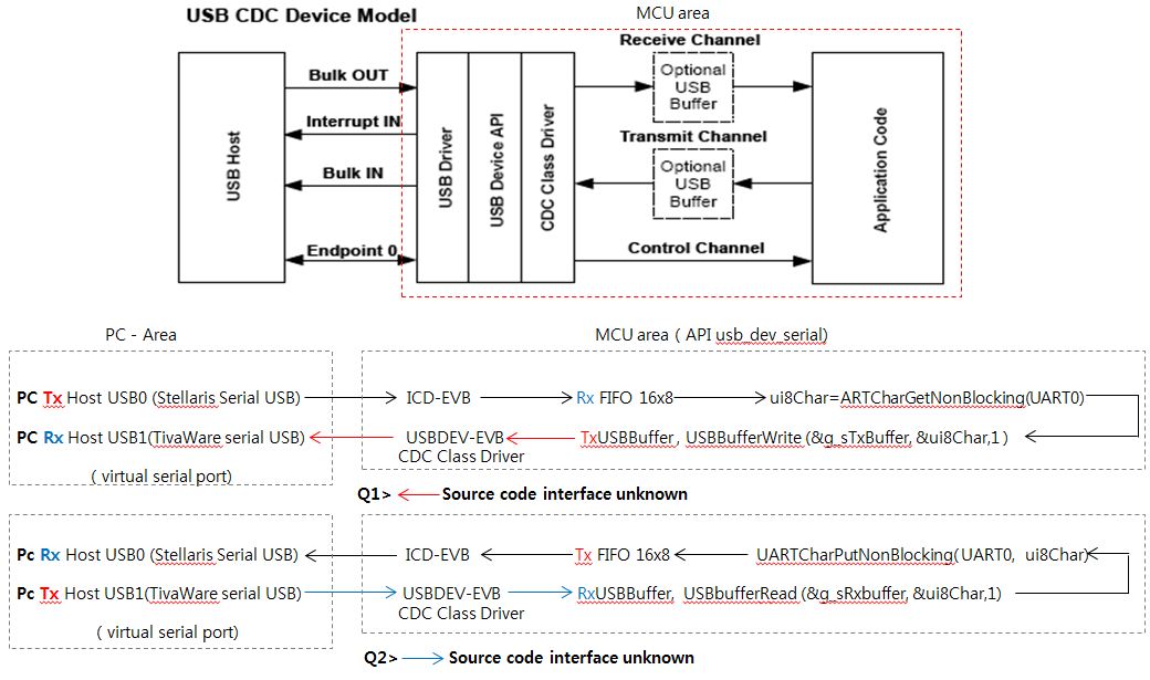

  • Hello Charles,
    I understand what you said.
    PC Host USB0 (Stellaris Serial USB) TX --------> ICD-EVB  -----------> Rx 16x8bit FIFO ---------------------------------------
                                                                                           1                                                                               2                                                          |
    PC Host USB1(TivaWare serial USB)RX <------  USBDEV-EVB <----- USB Tx Buffer ( g_pi8USBTxBuffer[256] )  <----
                                                                                              USBDCDC
    PC Host USB0 (Stellaris Serial USB) RX <------- ICD-EVB  <----------- Tx 16x8bit FIFO <-------------------------------------
                                                                                              1                                                                          2                                                            |
    PC Host USB1(TivaWare serial USB)TX ------>  USBDEV-EVB ------> USB Rx Buffer ( g_pi8USBRxBuffer[256] )  ----
                                                                                              USBDCDC
    1 : Bulk IN/Out, Interrupt IN, Endpoint0   64Byte/s
    2. Hardwire Tx/Rx FiFO Size 16byte

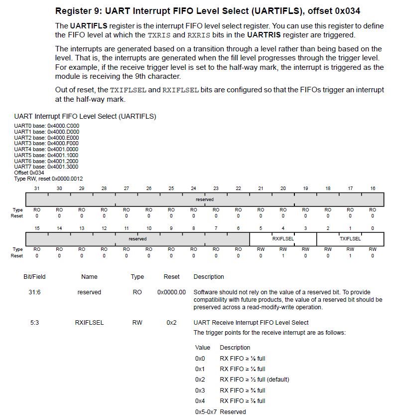

    Q1> What does UART_FIFO_TX4_8 mean by setting the FIFO interrupt level in the UARTFIFOLevelSet () function  ?
           4 bytes, 25% of the total size of the FIFO, will be filled. So the USBUARTintHandler () function is called four times.

  • Hi Jame,
      Your understanding is correct except that the UART_FIFO_TX4_8 is to interrupt at half  (8 bytes out of 16 bytes) of the FIFO or 50%. Therefore, the USBUARTintHandler  will be called 8 times more quickly compared to when the USB is receiving/transmitting.

  • Hi Jame,
      Please go to the uart.h file for the MACRO definition.
    // Values that can be passed to UARTFIFOLevelSet as the ui32TxLevel parameter
    // and returned by UARTFIFOLevelGet in the pui32TxLevel.
    #define UART_FIFO_TX1_8         0x00000000  // Transmit interrupt at 1/8 Full
    #define UART_FIFO_TX2_8         0x00000001  // Transmit interrupt at 1/4 Full
    #define UART_FIFO_TX4_8         0x00000002  // Transmit interrupt at 1/2 Full
    #define UART_FIFO_TX6_8         0x00000003  // Transmit interrupt at 3/4 Full
    #define UART_FIFO_TX7_8         0x00000004  // Transmit interrupt at 7/8 Full

  • Hello Charles,
    I don't know the source code interface in the Usb dev serial API.
    Q1> How do you send the data in g_sTxBuffer to PC Rx Host USB1 (Bulk IN) using which source code?
    Q2> How do I get to g_sRxbuffer using which source code from PC Tx Host USB1 (Bulk OUT)?

  • Hi Jame,
      Please refer to the usbbuffer.c and usbdcdc.c under <TivaWare_Installation>/usblib for the source code. You will find USABufferRead() and USBBufferWrite().

  • Jame,
    Jame shin said:
    Q1> In the words of Cb1 and staff, if the FIFO is enabled, does it wait for 8 bytes in the FIFO and then print it to the next USB0( via ICD) receiving terminal window?
    Regardless in FIFO mode or not, as soon as you write to the FIFO, the transmission will start. There is a 16 bytes deep TX FIFO. The threshold to generate the TX interrupt is programmable. Let's suppose you program the TX interrupt FIFO trigger level to 1/2. This means that the interrupt is only generated after there are 8 bytes or less in the FIFO. The processor could have written 16 bytes to the TX FIFO in a burst. After the first byte is written to the TX FIFO, the transmission starts. You should see the START bit on the UART TX pin immediate if you use the scope to capture. After 8 bytes are transmitted out, there is only 8 bytes left in the FIFO. This is the time when the TX FIFO interrupt is generated to notify the processor write more data to the TX FIFO.
  • Hi Charles,
    May it be noted - that such 'highly similar' data 'WAS' previously presented to this poster?'
    cb1_mobile said:
    Having 'stumbled in' - crack crüe reports (this gleaned directly from the '123's) Manual:
    "For transmission, data is written into the transmit FIFO. If the UART is enabled, it causes a data frame to start transmitting with the parameters indicated in the UARTLCRH register.  Data continues to be transmitted until there is no data left in the transmit FIFO."
    and
    "The trigger points at which the FIFOs generate interrupts is controlled via the UART Interrupt FIFO LevelSelect (UARTIFLS) register (see page 922).   Both FIFOs can be individually configured to trigger interrupts at different levels.    Available configurations include ⅛, ¼, ½, ¾, and ⅞."
  • Hi cb1,
     Thank you and sorry I missed you already replied the same.
  • Hello Charles,
    I have seen the USBL-UG documentation and the source code you mentioned.
    I was understand the interface that is sent and received between the USB host and the API.
    And, the description of FIFO is better explained step by step rather than Datasheet.
    Excellent !!
    Thank you for the explanation guide.
    regards,
    Jame,Shin
